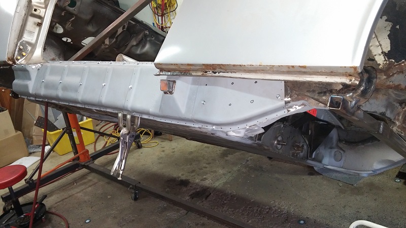

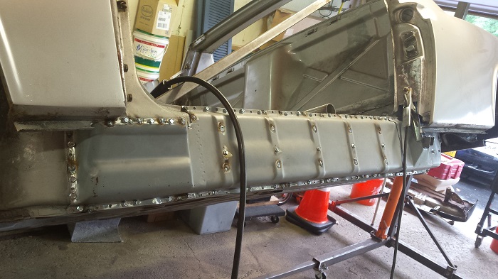

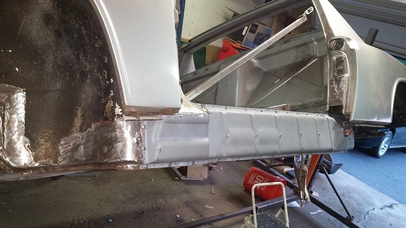

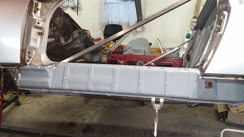

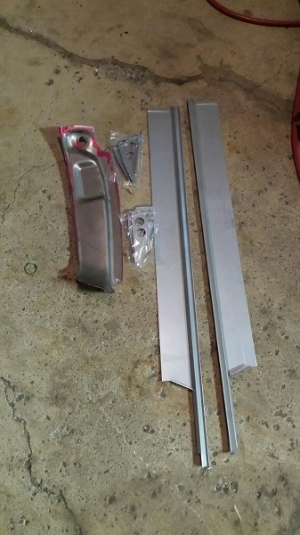

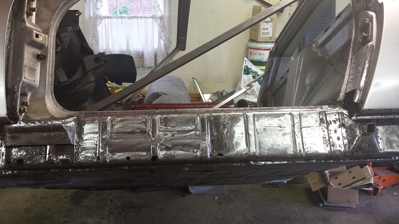

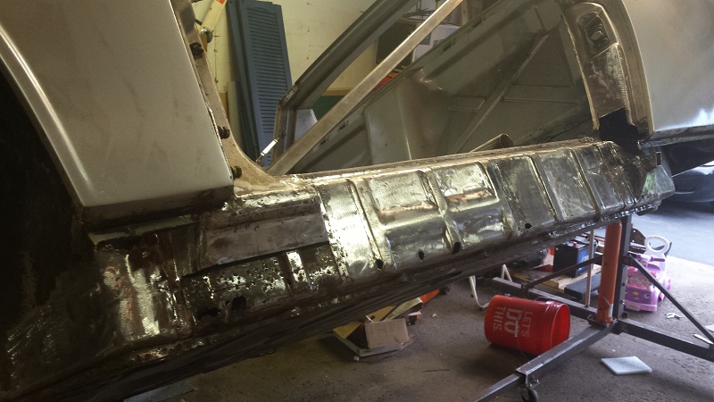

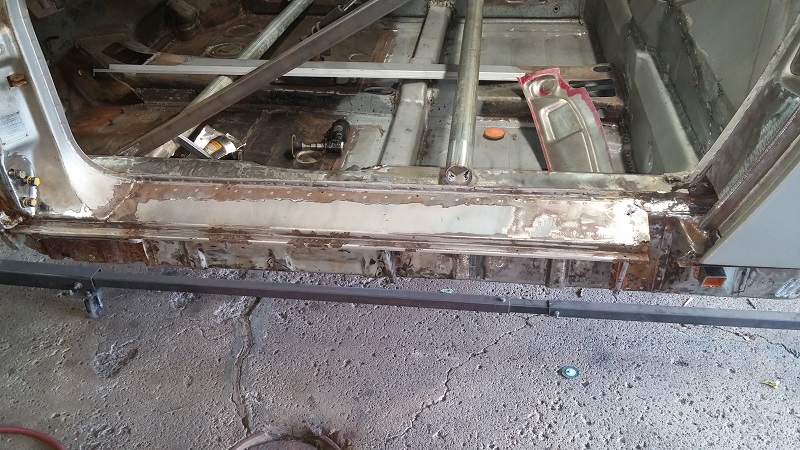

My brother and I got a few more things done on his 914.
Took the door sill off and lower rusty door jam.
We fixed a few spots in the long and test fitted the RD longitudinal frame stiffener overlays. Just an fyi, if you have a GT kit installed and plan to use these they will require some fitting at the rear by the outer suspension mounts.
Next we will remove the stiffener, coat the longs, and test fit the door prior to welding them in.
(IMG:style_emoticons/default/smash.gif) (IMG:style_emoticons/default/welder.gif) (IMG:style_emoticons/default/drunk.gif)
