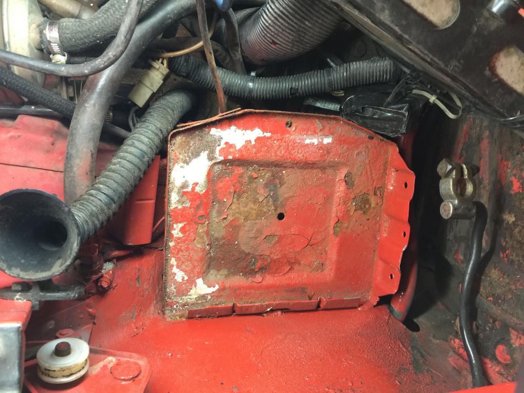

I am trying to sell my 914 and have had several people ask me about this "box" that they have seen in the photos next to the battery. The box they are referring to is the Control Unit. I have it ziptied onto the battery because I am not sure where it goes.
So, I have seen photos of other 914s with the ECU mounted onto the battery tray next to the firewall. However, on my car I have a air conditioning compressor and hose right in the way. Can anyone assist me in where this control unit goes on a 914 with an air conditioning unit? Any ideas? Attached thumbnail(s) |

Oh, here is another photo without the battery.
I also found another post that I think answers my question. I am missing the ECU mounting bracket: http://www.914world.com/bbs2/index.php?sho...=139453&hl= Attached thumbnail(s) |
monster8 Control Unit Location For 1975 Porsche 914 1.8L Jun 12 2015, 02:56 PM
monster8 So, just to add, I found that AutoAtlanta sells a ... Jun 12 2015, 03:11 PM
type47 Look in the bottom picture with the 3 holes in the... Jun 12 2015, 03:15 PM
Dave_Darling On cars that had A/C installed, the ECU was moved ... Jun 12 2015, 04:24 PM
914Sixer Dave is correct about cars with A/C. Installers d... Jun 13 2015, 12:33 PM
monster8 Wow, cool! Thanks for the information. No wo... Jun 13 2015, 01:07 PM![]() ![]() |
