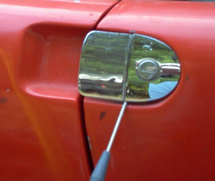

High on the list of bad design is the 914 door handles. While my passenger side has been tricky since the date of production, the drivers side has pretty much always worked... until the last torrential rain. Now it won't catch, no matter how many times I work the lock. It's been days now and I must get resolution. Please help. ~Bruce

insert and push"if youre worried about youre paint just put a piece of tape over the paint couple pieces will do "this dosent move the handle or damage the car.you wont hear it click but when the piece of metal is all the way in pull on the door.
