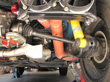

Not the best pic, but the only one I have of my setup (taken from the PO's FS listing, but the setup hasn't changed).
Setrab oil cooler with a pair of 5" Spal puller fans. Fans are activated via a 180 degree thermostatic switch, and I've also got the Tangerine inline oil cooler bypass so nothing goes to the oil cooler until temps get up. The front of the cooler has a manifold with two inlets that attaches to the orange ducting. There's a NACA duct in the rocker feeding one of the inlets, and the other inlet is fed via fresh air from the engine grill.
This setup is actually too good. I have to beat the shit out of the car to get oil temps over 200. Typical around town driving has me at 160-180. I actually need to figure out a way to get my oil temps higher!
I've tried removing the ducting, so that the oil cooler is only fed by the air flowing under the car, but the impact was only minimal. And this is in 90+ degree NC summer weather.
I've been thinking about getting rid of the fans.
