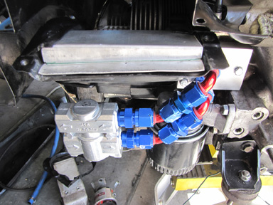

Ordered the smaller setrab unit with fan to replace the oil cooler that was installed when I bought the car (pictures). The new setrab unit is way smaller than I thought it would be. In fact, it's about half the size of what's installed now. I'm pretty sure the bigger setrab unit with the double fans is too big for this space. Anyone see issues if I run two of these smaller units in series? That way I can install them staggered and will fit in that space quite nicely.

how are you tapping the new oil lines to the new cooler in to the old?

Stock oil cooler gets removed. This is the tangerine oil cooler take off kit, with the air deflector to improve cooling on cylinders 3 and 4.

McMark   Yes, but running them in parallel is better.   May 22 2015, 08:12 PM

McMark   Oil cooling works best when there is a large diffe...   May 23 2015, 02:18 AM

rtalich   Just a quick update. I finally installed the setra...   Jun 14 2015, 11:51 AM
Mike Bellis   That's a cross flow cooler. Supposed to have m...   Jun 14 2015, 11:54 AM
Andyrew   /\ I agree, turn the cooler so you can see it...   Jun 14 2015, 12:01 PM
bdstone914   In referance to posts #18 and #19: Yes that is a ...   Jun 14 2015, 12:08 PM
rtalich   Thanks guys!! I will be driving it this we...   Jun 14 2015, 12:19 PM
rtalich   Well... It was pretty warm today... 80 degrees out...   Jun 15 2015, 06:26 PM
