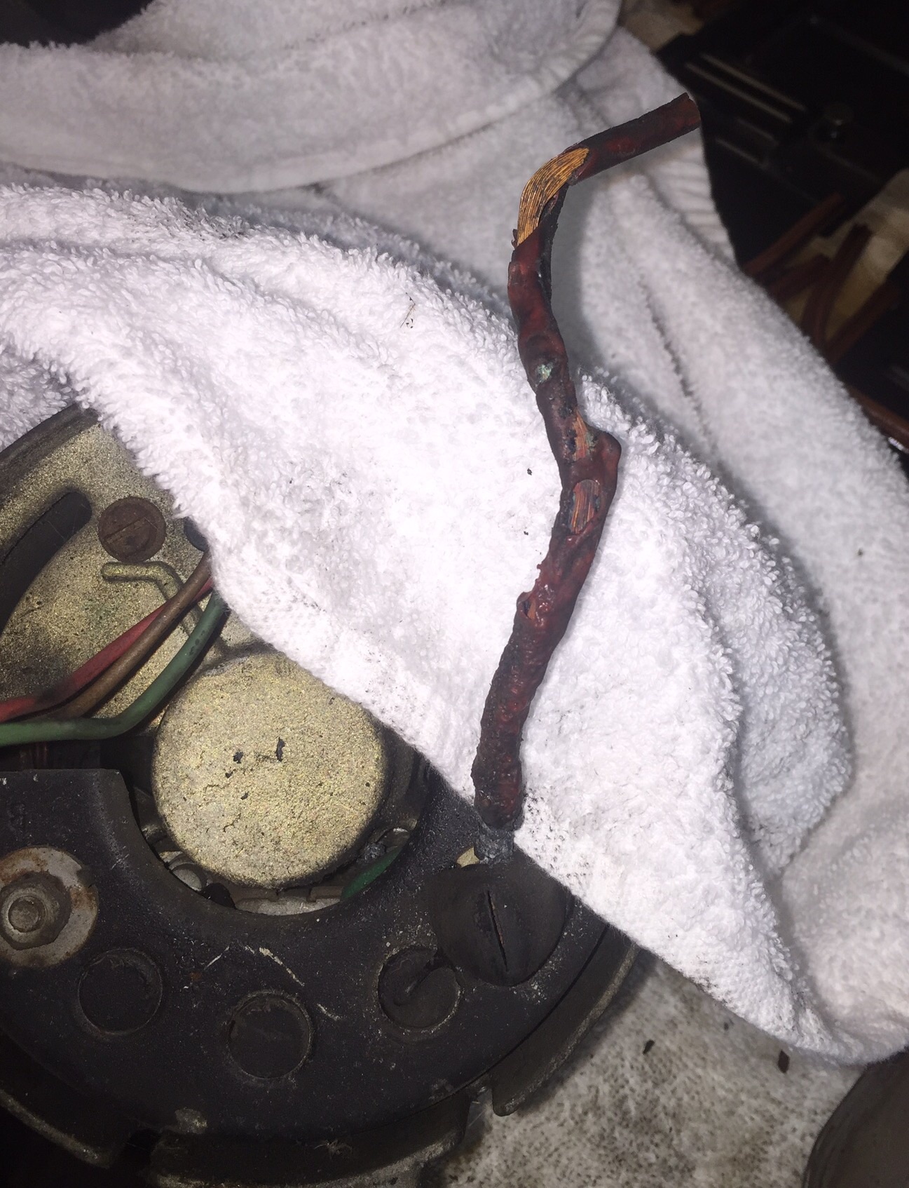

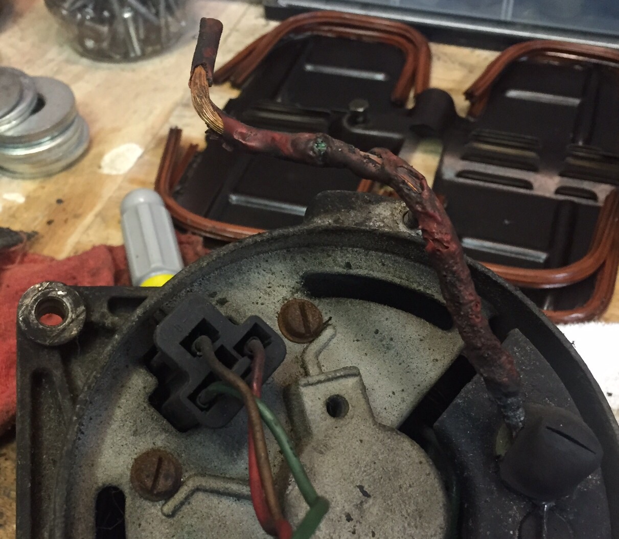

I was asked why do we need to replace our wiring let alone up our electrical load capabilities.
Instead of going on a long dissertation I thought that I would provide a picture of an original OEM system that was taken out of a car to do one of my conversions.
Too much draw through too little wire. I wonder if it provided any illumination ...like a light bulb filament?
I will let the pictures do the talking.
