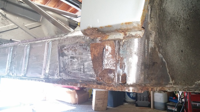

I figured why not start this thread. The car is a 74 914 2.0 that's been sitting since the early 90's. It was parked outside/in the woods up until my brother purchased it last fall. It didn't look too bad from 20 feet away but when you look closer it gets pretty bad. So, here's the plan... strip the car, fix the rust problems, paint it, add a 5 lug suspension, and convert it to a 3.0 6. Stay tuned for pics of the progress..

Wrapped up the drivers side and moved on to the pass side.

Luke M   Replacing the r/r inner control arm mount was a re...   Jun 24 2013, 07:08 AM

Luke M   The work continues. The right long is done and sta...   Mar 2 2014, 07:49 PM

Luke M   We got the floor pan/seat mount reinforcement all ...   Apr 19 2015, 08:09 PM

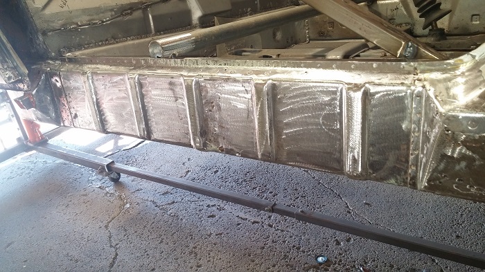

Luke M   Back to it here.. :smash: :welder: We got the ...   Jun 4 2015, 09:28 AM
Luke M   My brother and I got a few more things done on his...   Jun 10 2015, 08:49 AM

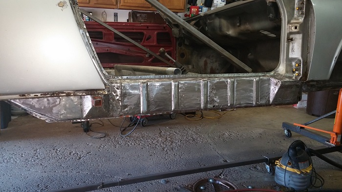

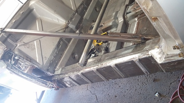

Luke M   We got the drivers side chassis stiffener, door si...   Jul 1 2015, 07:09 AM
Luke M   Wrapped up the drivers side and moved on to the pa...   Jul 2 2015, 08:12 PM

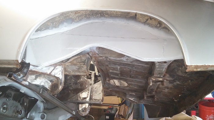

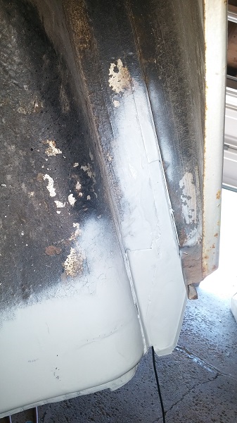

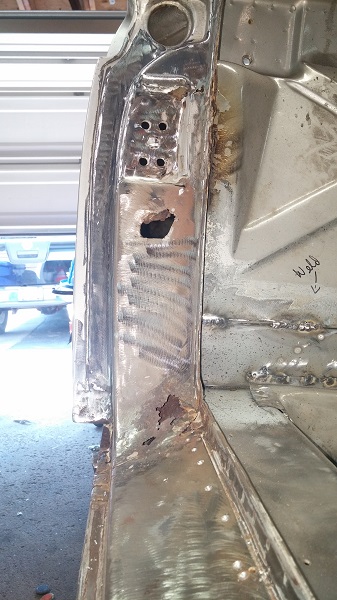

Luke M   Moving forward on the pass side. Cut out and repla...   Jul 12 2015, 08:26 PM
Luke M   It's been way too hot and muggy here to do any...   Aug 6 2015, 09:04 AM
