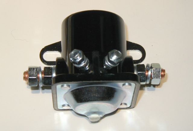

QUOTE(HalfMoon @ Jul 4 2015, 11:53 AM) *
Local parts stores emplyee's often won"t know what to look for without a part number or year/make/model.
Not sure if the one pictured in a previous post was the ford relay.
Anyone know this information?
You need to find a FLAPS that have counter persons that are not total fuching morons.
It's a standard solenoid used on fords from 1964 to 1989 on about a 1000 models of ford cars trucks.
(IMG:http://www.914world.com/bbs2/uploads_offsite/www.autorewire.com-26-1436026057.1.jpg)
https://www.google.ca/search?q=ford+fender+...id+&imgrc=_
