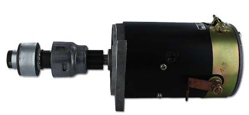

To summarize the various posts on the subject, the pictured Ford starter solenoid is redundant and thus overkill for the type of starter system on a 914. A HD relay is all that is needed to provide full battery voltage to energize the factory-mounted solenoid.
Most starter motor assemblies use a solenoid mounted on the motor with linkage to move the flywheel pinion gear into mesh with the flywheel while at the same time energizing the motor. Older Fords used a Bendix drive motor that moves the pinion gear without need for linkage, thus a separate solenoid to merely energize the motor.
<1964 Ford starter
