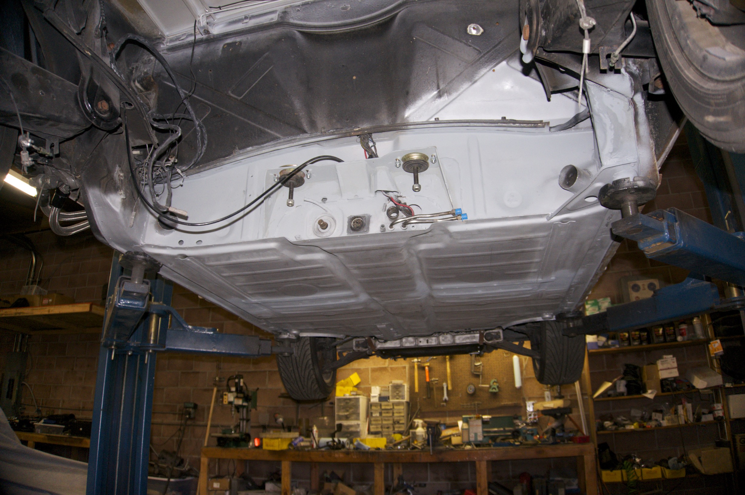

Now that I have the 2.0 running adequately its time to tackle the rust issues...
When I first looked this car over I was so excited about getting it I didn't look as thoroughly as I should have. The cost of excitement I suppose...
Although what I am about to show you isn't nearly as bad as some of the amazing restorations I have seen on this site, I still feel it is necessary to show you what I am dealing with! My hopes are that I can be pointed in the right direction.
I am partially embarrassed to even show these pictures as the rot is minimal by comparison to what I've seen some members work with...
here goes nothing...

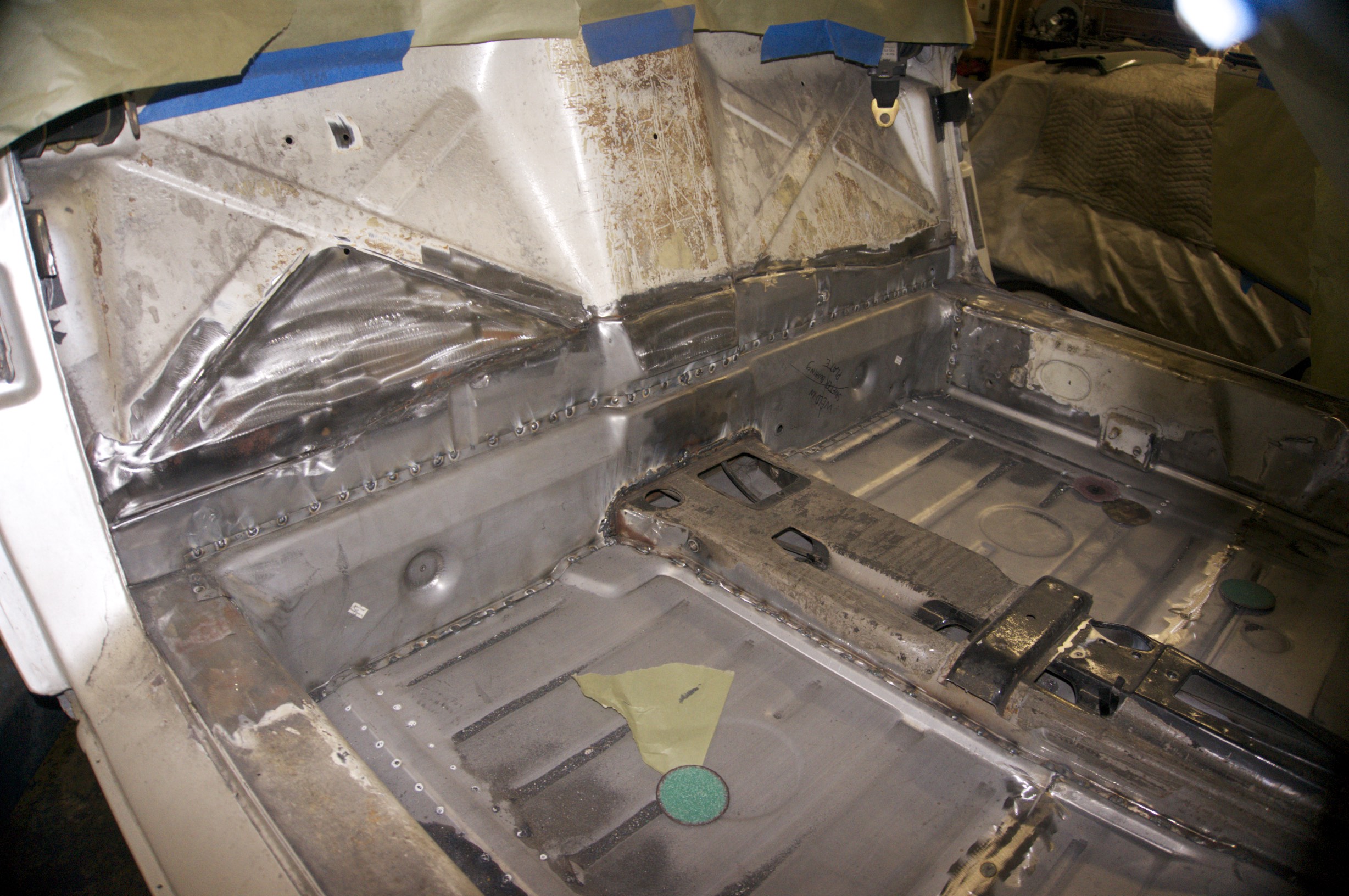

all the interior removed:
(IMG:http://www.914world.com/bbs2/uploads_offsite/i98.photobucket.com-13631-1432590830.1.jpg)

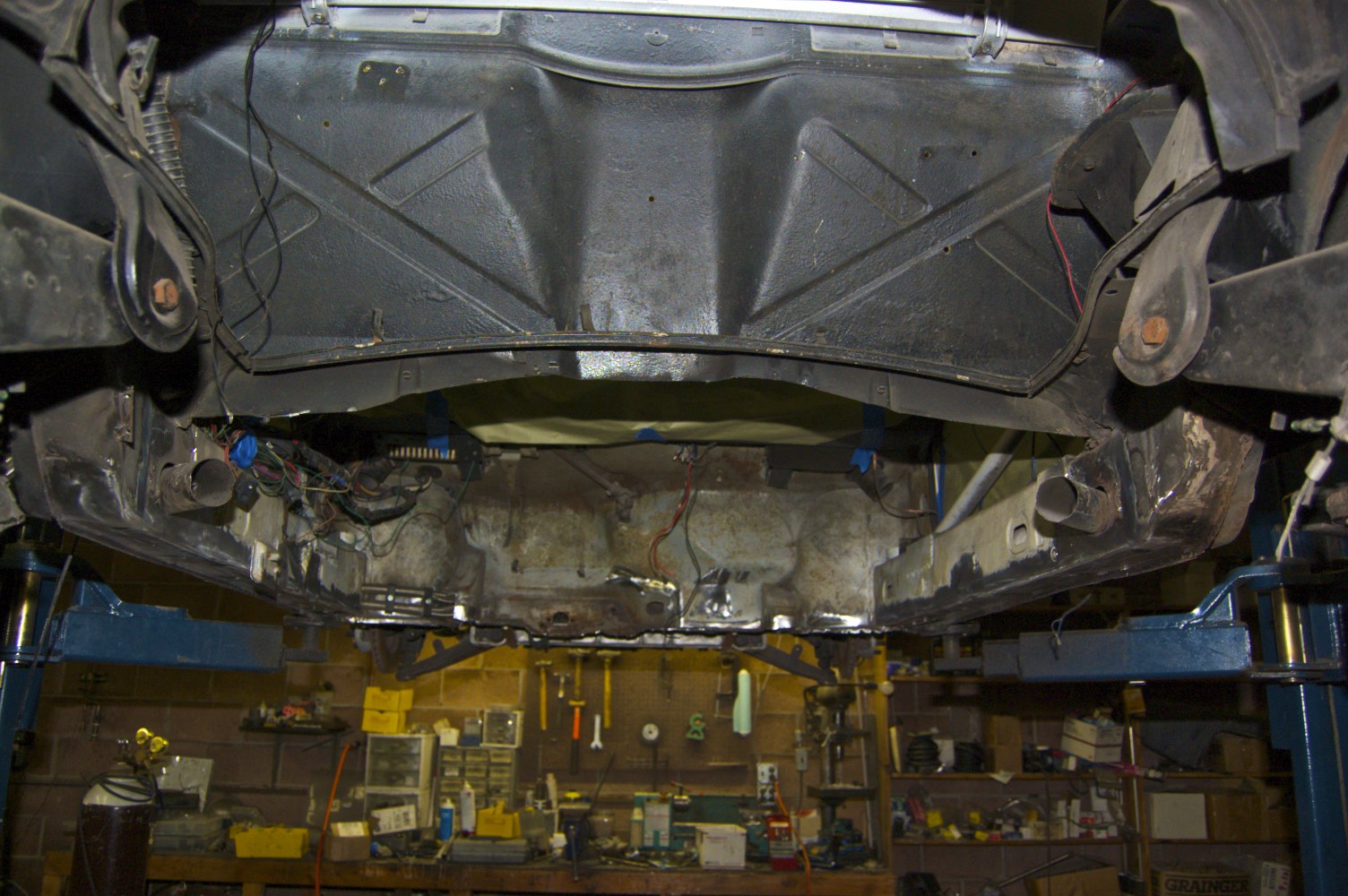

(IMG:http://www.914world.com/bbs2/uploads_offsite/i98.photobucket.com-13631-1432590831.2.jpg)

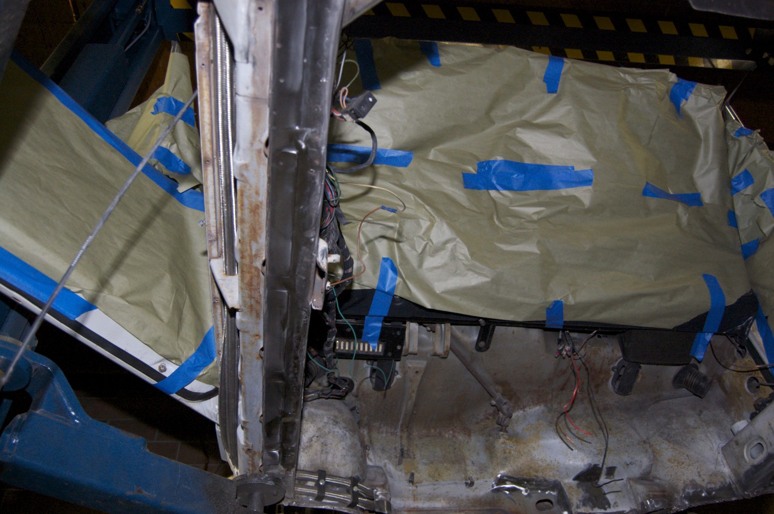

(IMG:http://www.914world.com/bbs2/uploads_offsite/i98.photobucket.com-13631-1432590831.3.jpg)

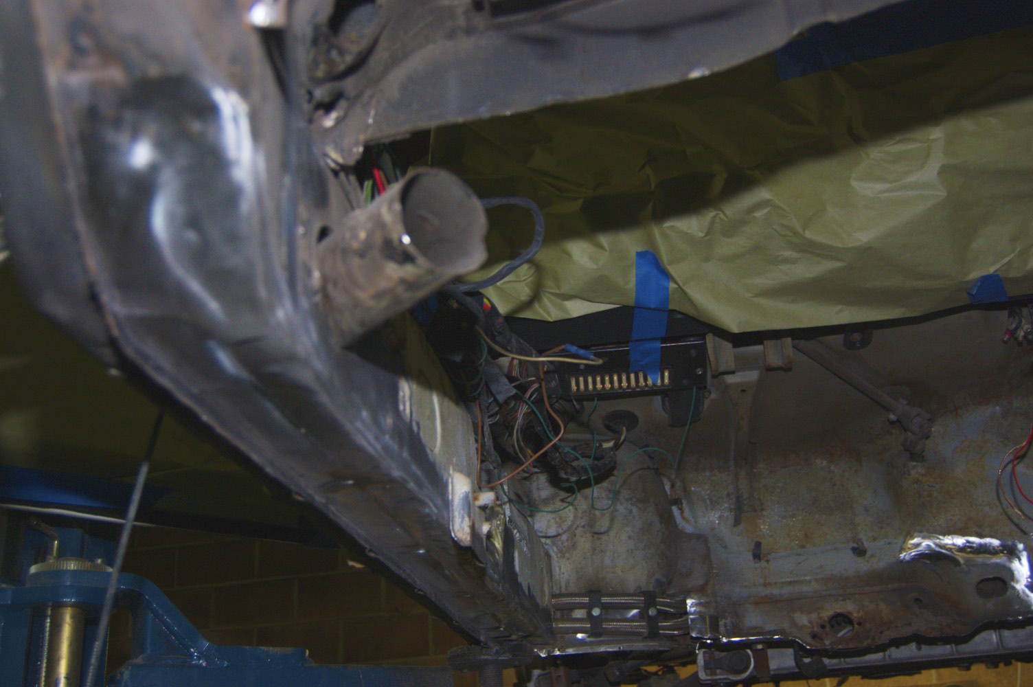

(IMG:http://www.914world.com/bbs2/uploads_offsite/i98.photobucket.com-13631-1432590831.4.jpg)

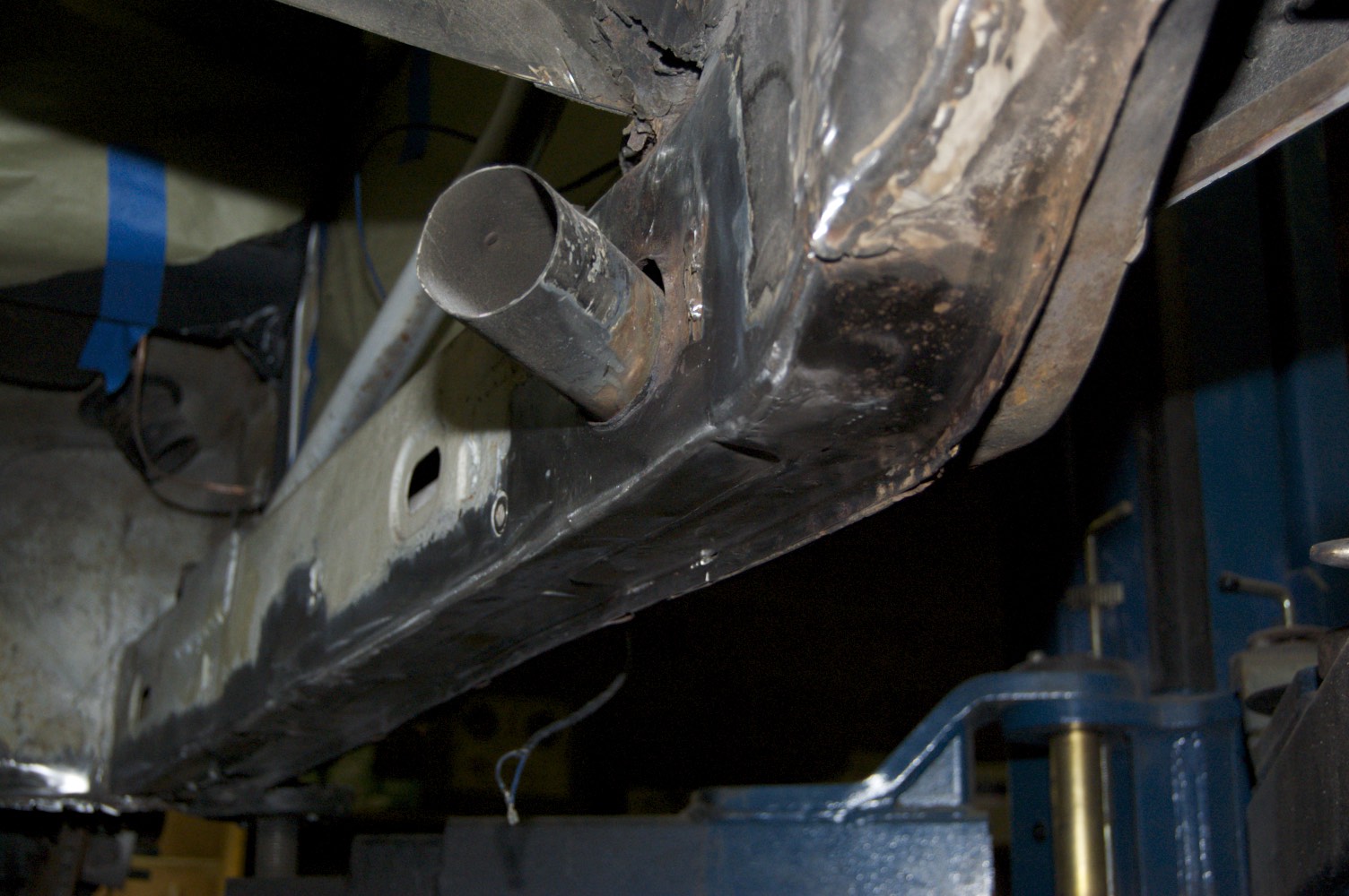

seat mount is completely gone:
(IMG:http://www.914world.com/bbs2/uploads_offsite/i98.photobucket.com-13631-1432590832.5.jpg)

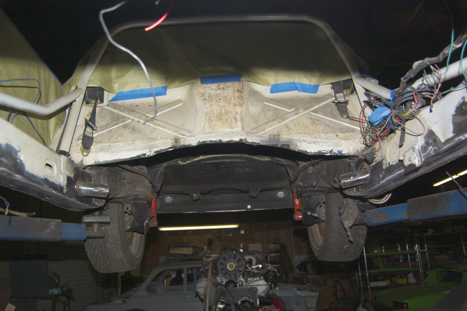

Just behind the passenger seat... directly over the jack mount area:
(IMG:http://www.914world.com/bbs2/uploads_offsite/i98.photobucket.com-13631-1432590832.6.jpg)
Same area as from the previous pictures only look from under:
(IMG:http://www.914world.com/bbs2/uploads_offsite/i98.photobucket.com-13631-1432591623.1.jpg)
nearly completely separated from the top of the tunnel:
(IMG:http://www.914world.com/bbs2/uploads_offsite/i98.photobucket.com-13631-1432590832.7.jpg)

Nemisus   Under the car looking towards the front: Tunnel is...   May 25 2015, 03:54 PM

mepstein   I don't think your rot will be minimal. Pull t...   May 25 2015, 04:26 PM
SirAndy   you will find more rust :agree: That looks pre...   May 25 2015, 05:21 PM
Cairo94507   Rust never sleeps.....ask us how we know!   May 25 2015, 04:43 PM
boxsterfan   Looks like the car was POR-15'd at some point ...   May 25 2015, 05:19 PM

boxsterfan   It's a rust inhibitor paint. Problem is that i...   May 25 2015, 06:41 PM

Mike Bellis   This is your longitudinal frame rail and structura...   Jun 6 2015, 10:11 PM
SirAndy   This is your longitudinal frame rail and structura...   Jun 6 2015, 11:50 PM
brant   You really need to look under the rockers. I thin...   Jun 6 2015, 10:49 PM
Nemisus   This is your longitudinal frame rail and structur...   Jun 7 2015, 01:24 AM
