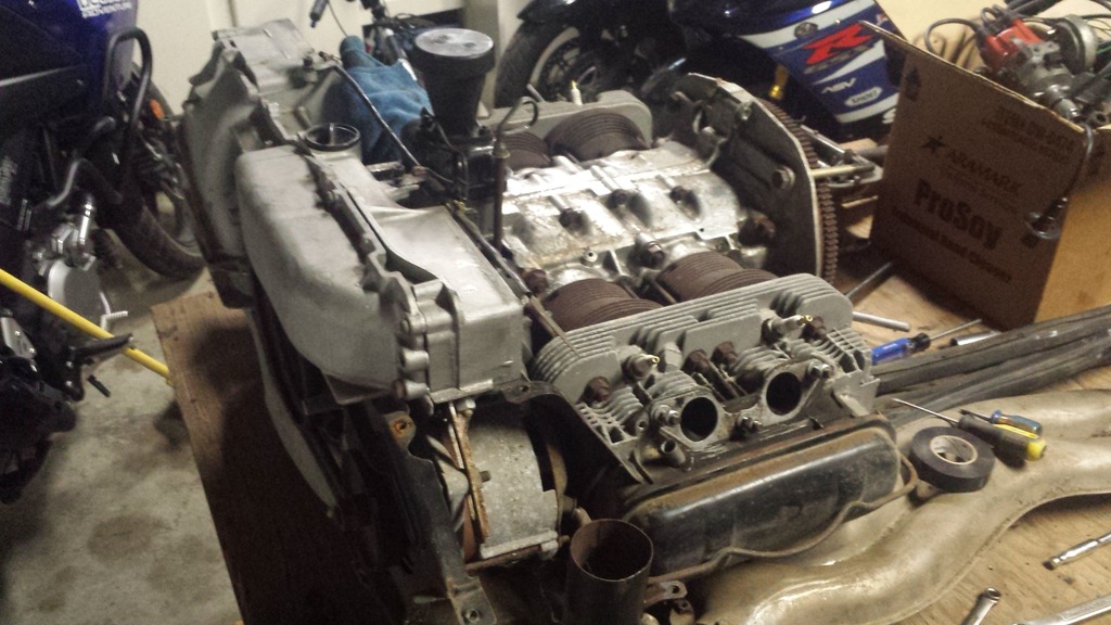

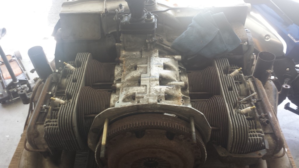

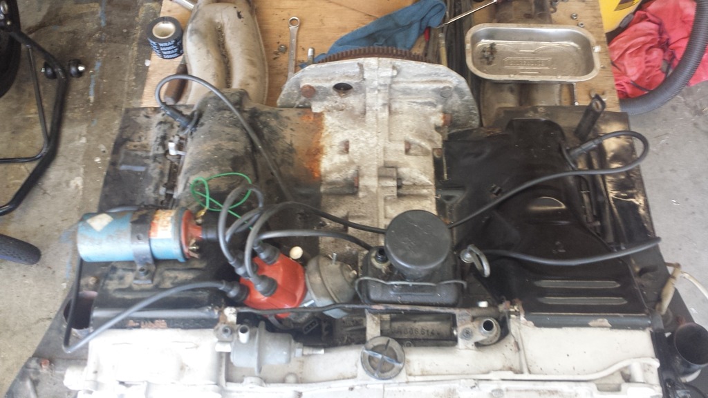

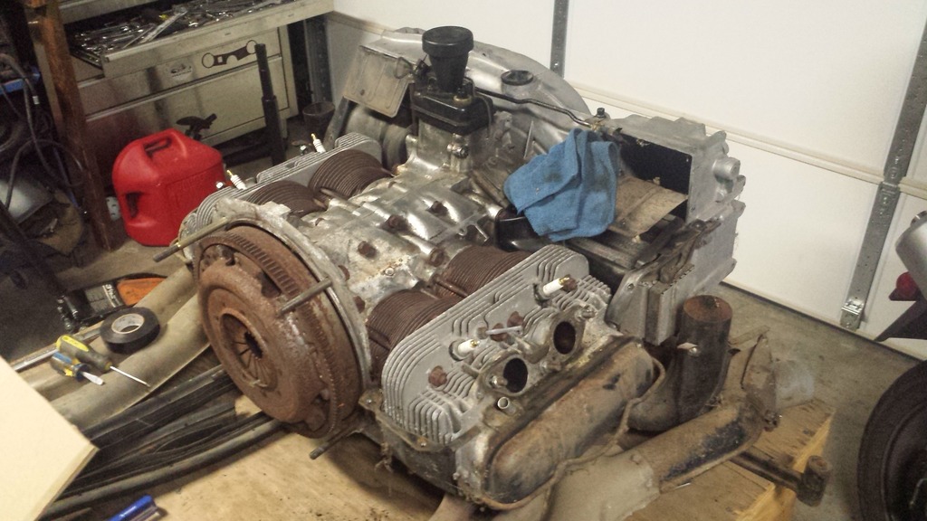

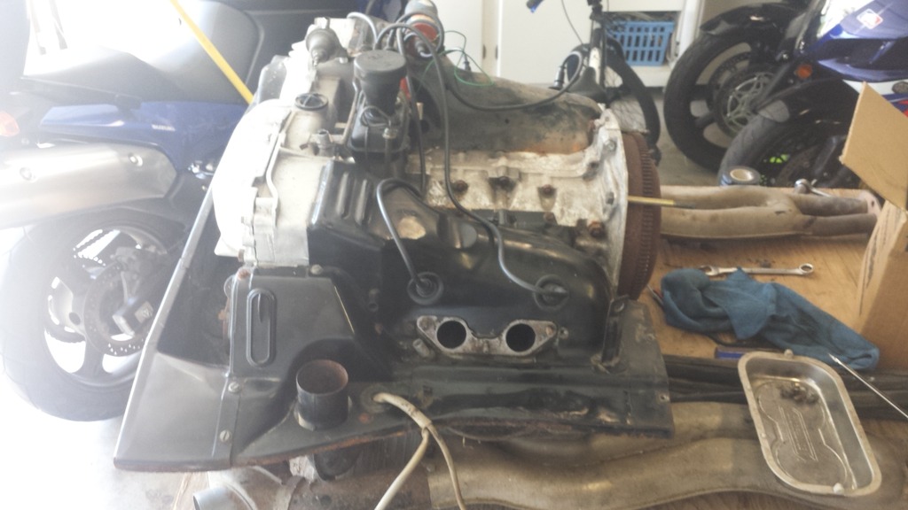

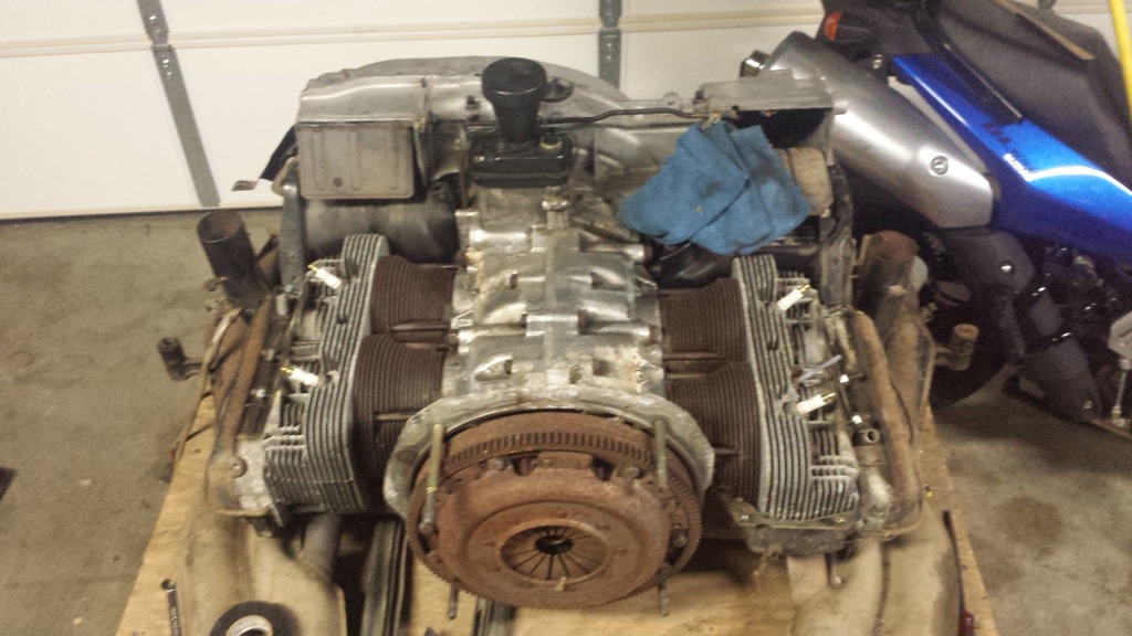

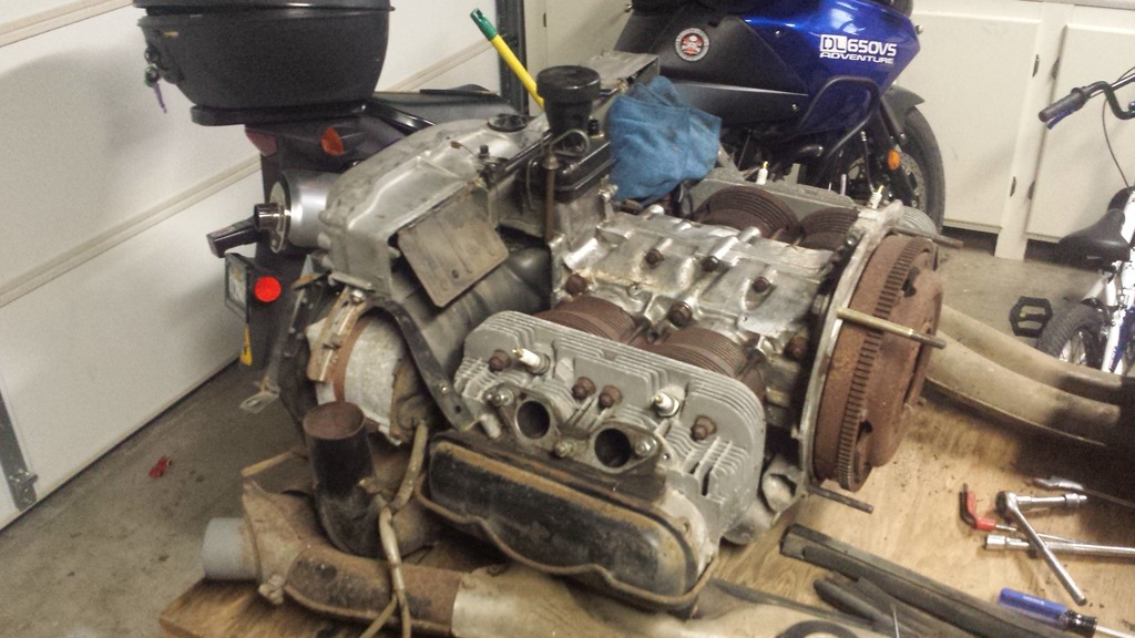

Update:
Since I am waiting on a new addition to my 74 project (HINT: its 42 years old and has a color code of L96M) I thought I would spend some time with the 2.0 getting it cleaned up and just overall see how things look.
The 74 sat for what I think was about 6 years. As most of the previous pictures show there are a lot of webs and nests of sorts covering the car.
Anyhow... Here are some shots of a near naked 2.0.
Fuel Inject and most of the wiring harness removed: Just wiping down the tin made a big difference in cleanliness.
(IMG:http://www.914world.com/bbs2/uploads_offsite/i98.photobucket.com-13631-1436651553.1.jpg)
an over head:
(IMG:http://www.914world.com/bbs2/uploads_offsite/i98.photobucket.com-13631-1436651553.2.jpg)
almost all the tins removed: Had to take a break and have lunch
(IMG:http://www.914world.com/bbs2/uploads_offsite/i98.photobucket.com-13631-1436651553.3.jpg)
(IMG:http://www.914world.com/bbs2/uploads_offsite/i98.photobucket.com-13631-1436651553.4.jpg)
(IMG:http://www.914world.com/bbs2/uploads_offsite/i98.photobucket.com-13631-1436651554.5.jpg)
(IMG:http://www.914world.com/bbs2/uploads_offsite/i98.photobucket.com-13631-1436651554.6.jpg)
(IMG:http://www.914world.com/bbs2/uploads_offsite/i98.photobucket.com-13631-1436651554.7.jpg)
That about does it for that. I have the 901 ready for a trip to Mark at Original Customs to get looked at. Figured I might as well use their services before the move. It will also give me some time to sneak a peak at the "new addition". (IMG:style_emoticons/default/lol-2.gif)
Stay Tuned,
Updates and more pictures soon.
Cheers
Nemi
