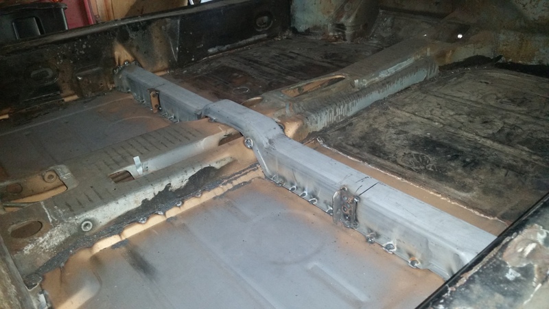

trojanhorsepower   Finally an update. Got the cross member welded in...   Jul 12 2015, 01:31 PM
trojanhorsepower   Also got the little seat adjuster bracket that wel...   Jul 12 2015, 01:34 PM
