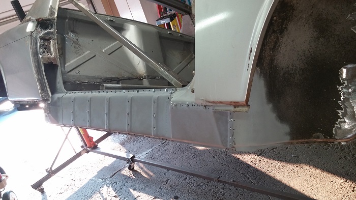

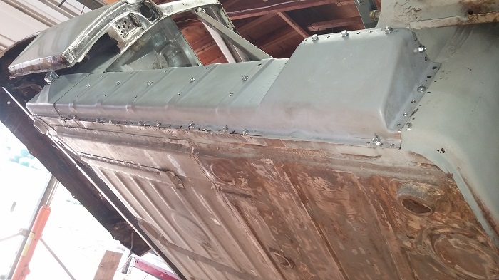

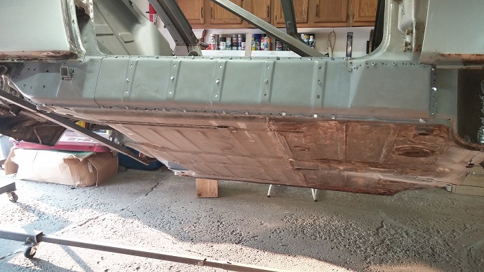

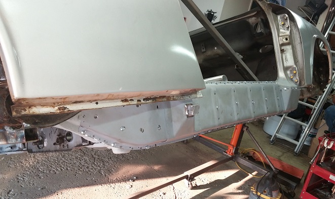

Moving forward on the pass side. Cut out and replaced the rusty metal with some from a parts car. Installed/prepped the right frame stiffener over the longitudinal.
Next step is to weld it in along with the door sill then the door jam and the
roof pillar panel. That should complete the pass side.
