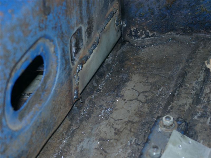

Hi guys,
look what i found under the fender. The PO did some very fine work to repair the hell hole (IMG:style_emoticons/default/ar15.gif)

additional pic from inside of the long. Have to drill a hole for the securitiy belt mounting. The mounting point is in good shape, so i only have to paint it and weld it.
Will keep you informed.
