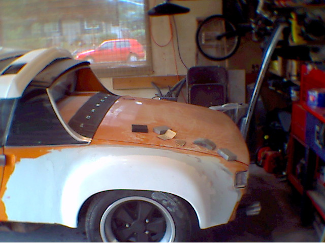

The only part I didn't like about molding them into the rest of the fender was the feathering on both rear fenders, the front of both. That is just EverCoat and it is really thin, but look how far I had to go with it to be able to put a straight edge across the fender. Dang, I hope no one ever bumps those parts! (IMG:style_emoticons/default/biggrin.gif)

Root_Werks   Left about a 3/8 lip to bond from both sides to. ...   Sep 13 2004, 10:41 AM
Root_Werks   The only part I didn't like about molding them...   Sep 13 2004, 10:43 AM
Root_Werks   Front, just about done.   Sep 13 2004, 10:44 AM
Root_Werks   Done.   Sep 13 2004, 10:45 AM
