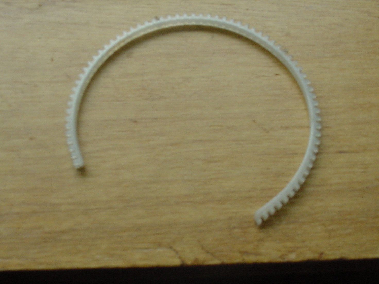

here is a shot of the cushions/wire protectors i pm'ed you about.
