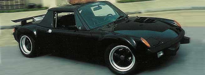

Maltese Falcon
Lucky9146,
Here is one angle of my '74.
Photo credit; Marco Gerace "Excellence" mag.
Is that white car running yet ? biggrin.gif Click to view attachment
