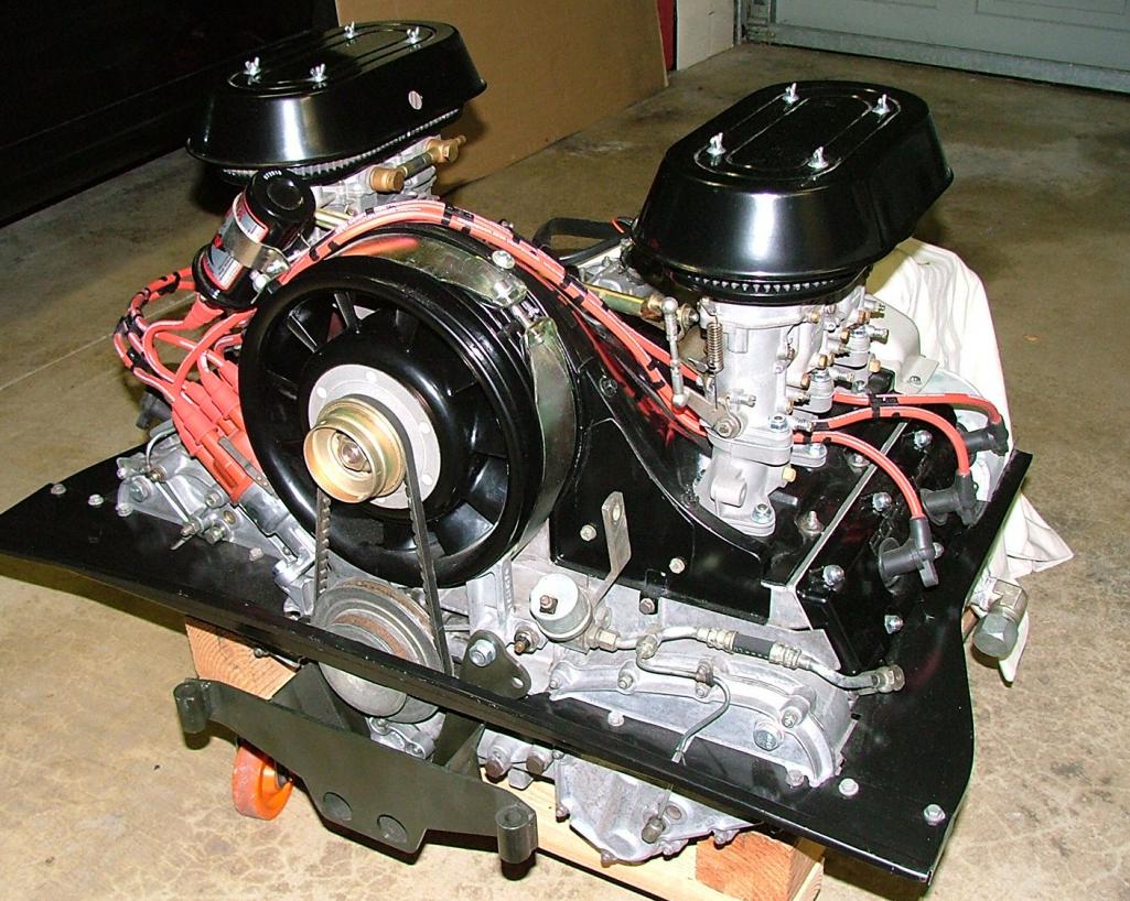

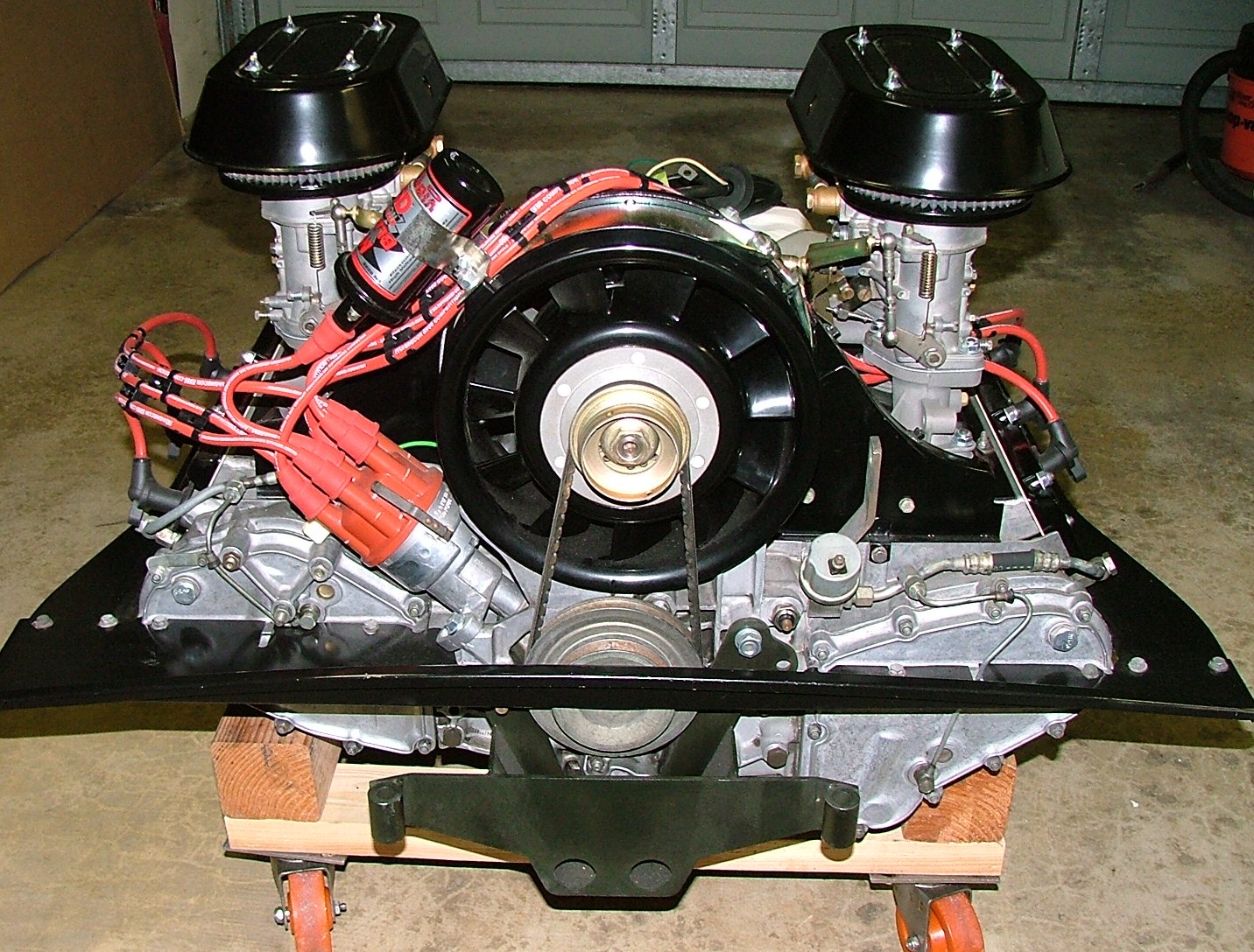

This car came with some really nice parts! Some it already had. Some purchased by the PO for the conversion. The PO did his homeowrk and it is going to take some time but I will show you a lot of what came with the car.
First pictured is the engine which is a 1979 3.0 with 39mm port heads, chain tensioners, turbo valve covers with fins trimmed to clear trailing arms then powder coated. A Jerry Woods complete distributor rebuild/ re-curve, MSD Blaster high vibration coil, Magnecor Spark Plug wires, new plugs. Valve clearances set. Dual Weber 40 IDA 3C carbs/manifolds/linkage, completely rebuilt and bench tested by Paul at Performance Oriented. Intake manifolds are glass beaded, port matched to the heads, new gaskets and phenolic spacers. New K&N Filters and powder coated rain hats. Note the cad plating and front mount installed. Yes this is how I got the engine!!!!!

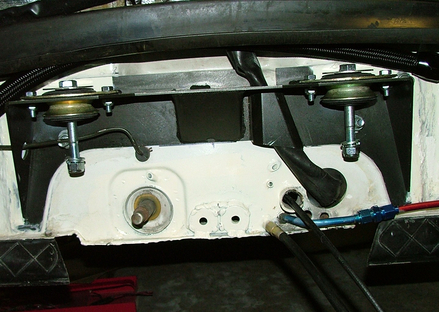

Next is the PO installed Rich Johnson engine conversion mount pictured and it is both bolted and welded.
