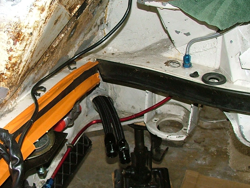

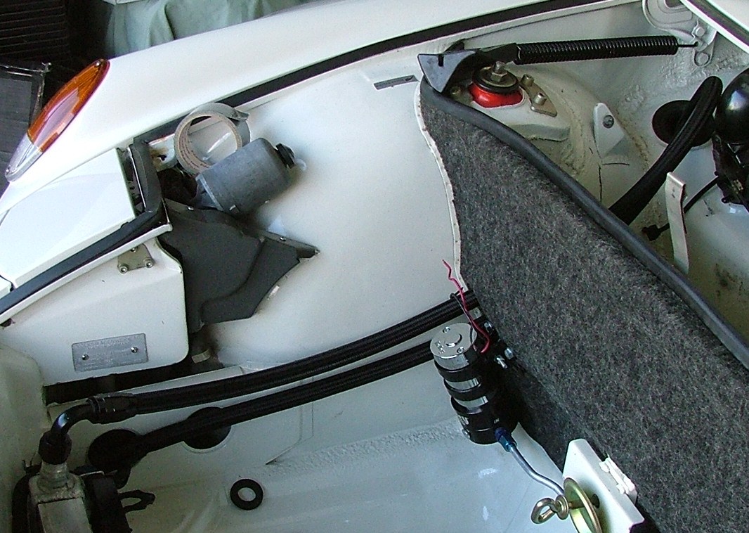

So I decided to run the oil hoses from the front trunk oil cooler back to the engine compartment through the passenger heater tube. A slick idea from the PO but I have to admit I was concerned they would actually fit as the hoses came made up with AN 12 fittings already on. The short story is it worked! I made numerous attempts trying different approaches wanting to avoid removing the fittings. Pictures will show that I filed the the sharp edges of the B nuts, purist will shudder, but they were actually cutting the duct tape as they came through the long tube being pulled by garden hose. In the heat of the moment and the sweat of the fun I neglected to take in process pictures (just imagine duct tape around the two hoses). The final approach was one at a time and you HAVE to have a another person to push as you pull. It really does look cool though! The upsides are; no cutting of holes in fenders, no external lines, very clean look when done. Downsides are; no heater, filing the B nut edges, modifying the heater tube just inside the engine compartment, and worst of all modifying the gas tank because the hose does not fit past the flange on the side of the tank! It is a nicely powder coated tank too. Have started modifying the tank by dimpling the side but the flange will need to be removed. More on that to follow.....
See my thread for Mazda RX7 oil cooler inlet /outlet info I used for routing.
http://www.914world.com/bbs2/index.php?sho...=261153&hl=

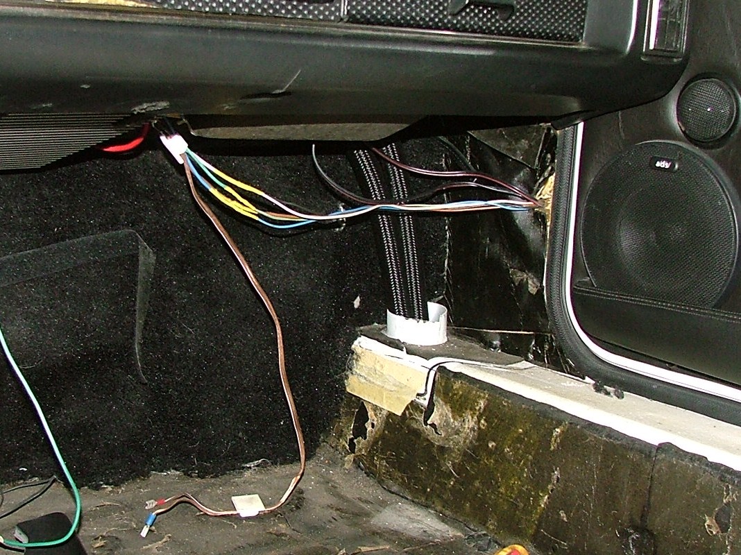

Lucky9146   The real elephant in the room for me is the wiring...   Aug 9 2015, 11:49 AM
porschetub   The real elephant in the room for me is the wirin...   Aug 9 2015, 12:46 PM
Lucky9146   I can't help but laugh @ your comments ,I...   Aug 9 2015, 01:13 PM
