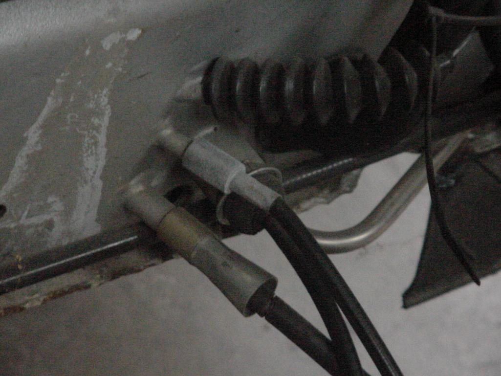

in this picture the top is the throttle cable. the bottom is the clutch. the large one to the right of them is the speedo. you seem to be missing something.

rhodyguy   in this picture the top is the throttle cable. the...   Aug 5 2015, 10:41 AM
Lucky9146   in this picture the top is the throttle cable. th...   Aug 5 2015, 11:09 AM
