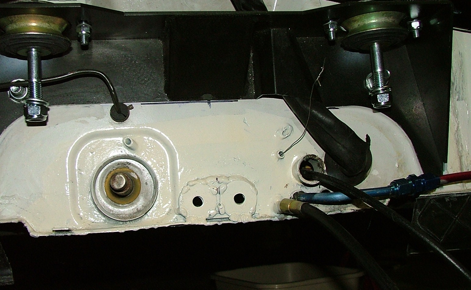

in this picture the top is the throttle cable. the bottom is the clutch. the large one to the right of them is the speedo. you seem to be missing something.

Thanks rhodyguy for responding to my PM with the picture of your cables. I was trying to figure out which tube the accelerator cable went through since the car came with out the cable. In my picture the PO welded flat washers as back stops for the center e-brake just left of the cables, and I like the idea. So on mine the clutch is on the left, the speedo goes through the larger opening up to the right and the speedo tube must be where I have the safety wire hanging out of. Note PO ran fuel line next to Clutch hole. Mine is a 74 what year is yours? Thanks again
