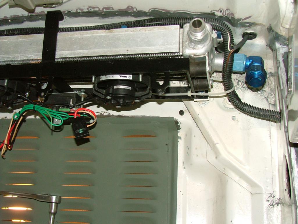

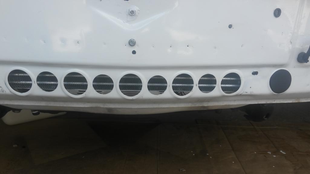

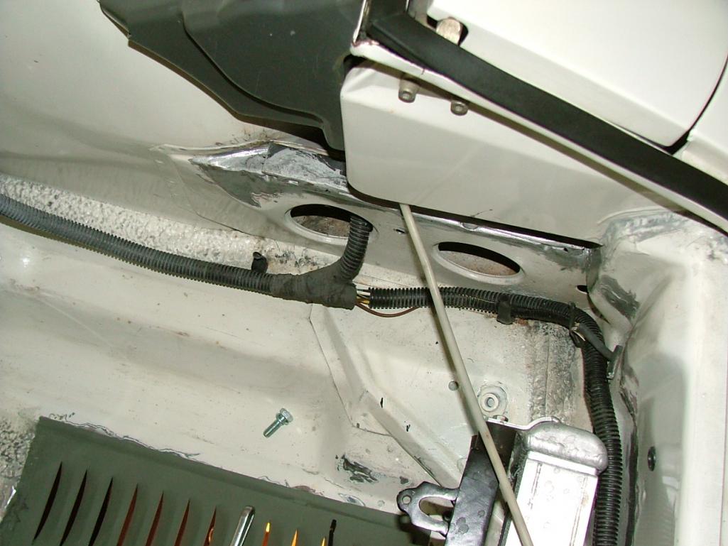

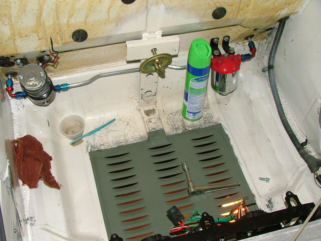

Pictures of front trunk as received. Louver was installed. Bracket had been added for compact spare tire mount. The oil cooler was mounted and I will cover that and the oil cooler shroud in more detail shortly. Note the PO added same size holes matching and between the original holes on the front for the oil cooler intake.

Lucky9146   Pictures of front trunk as received. Louver was i...   Aug 6 2015, 05:13 PM
Lucky9146   Minimal rust was treated with Pour 15, louver was ...   Aug 6 2015, 05:19 PM

Lucky9146   Front carpet reinstalled. Under front louver seale...   Aug 6 2015, 05:32 PM

Lucky9146   To continue on with the front trunk, oil cooler, a...   Aug 8 2015, 12:29 AM
Lucky9146   The PO installed oil cooler and card board mock up...   Aug 8 2015, 12:41 AM
Lucky9146   So I started with the mock up and some spare galva...   Aug 8 2015, 01:09 AM
