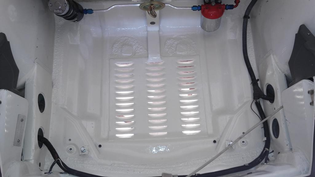

Minimal rust was treated with Pour 15, louver was sealed from top and bottom, and trunk painted.

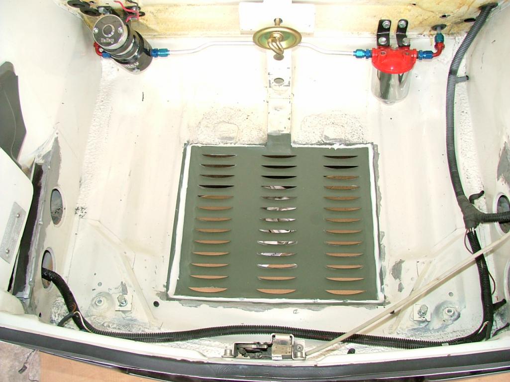

Lucky9146   Pictures of front trunk as received. Louver was i...   Aug 6 2015, 05:13 PM
Lucky9146   Minimal rust was treated with Pour 15, louver was ...   Aug 6 2015, 05:19 PM
