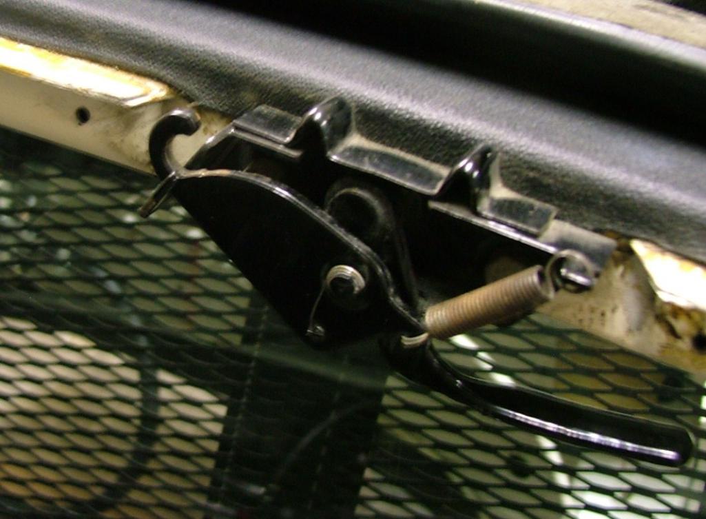

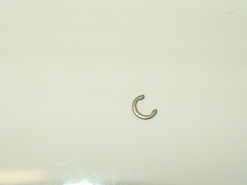

Have been looking for months for the cir-clip that hold the rear roof latch on the shaft that it rides on. Found it at Marshalls Hardware, huge selection of parts. San Diego Off Miramar Rd. Like I always say the devil is in the details.
