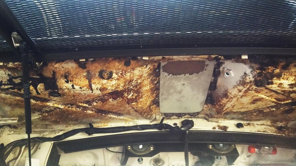

Engine compartment insulation was not installed when I got the car but the original insulation did come loose with the car but it was very tired. Also, it had a lot of extraneous holes in it so I used it for a template. Found some foil backed heat shield at ORW = Off Road Warehouse made by Competition Specialities (about $50). It worked well fitting it and glueing it in, mostly scissor work. Still need to do the back side of the access panel from the passenger compartment.
