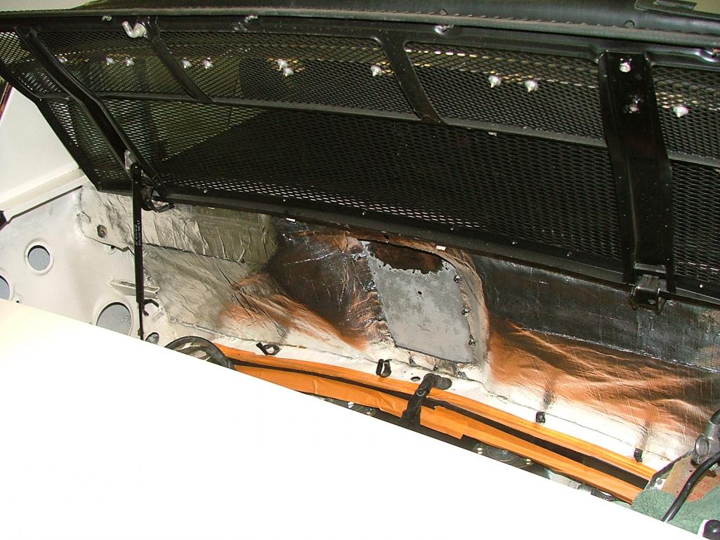

Lucky9146   Engine compartment insulation was not installed wh...   Aug 6 2015, 10:47 PM
Lucky9146   Insulation Installed   Aug 6 2015, 10:50 PM
