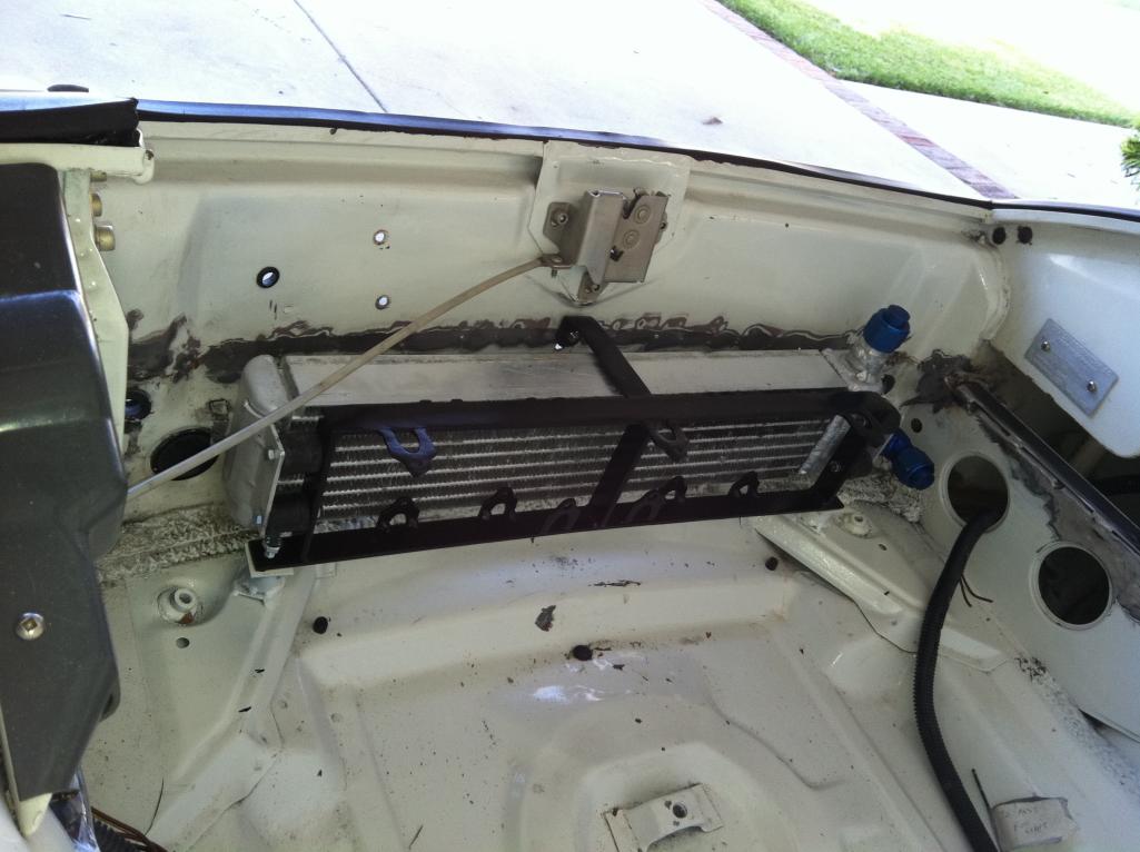

The PO installed oil cooler and card board mock up shroud. It is my understanding the Mazda cooler is wider making it harder to just buy a shroud.

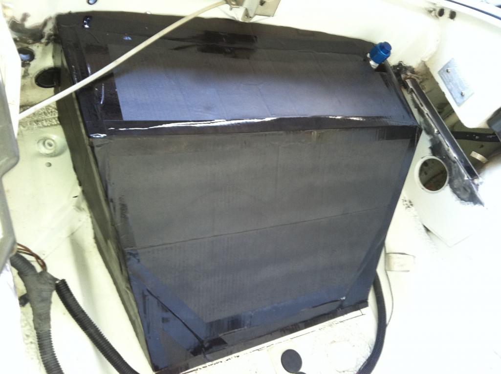

Lucky9146   To continue on with the front trunk, oil cooler, a...   Aug 8 2015, 12:29 AM
Lucky9146   The PO installed oil cooler and card board mock up...   Aug 8 2015, 12:41 AM
Lucky9146   So I started with the mock up and some spare galva...   Aug 8 2015, 01:09 AM
mepstein   Very nicely done!   Aug 8 2015, 06:57 AM
RobW   Very nicely done! :agree: :agree: Very ni...   Aug 8 2015, 07:08 AM
