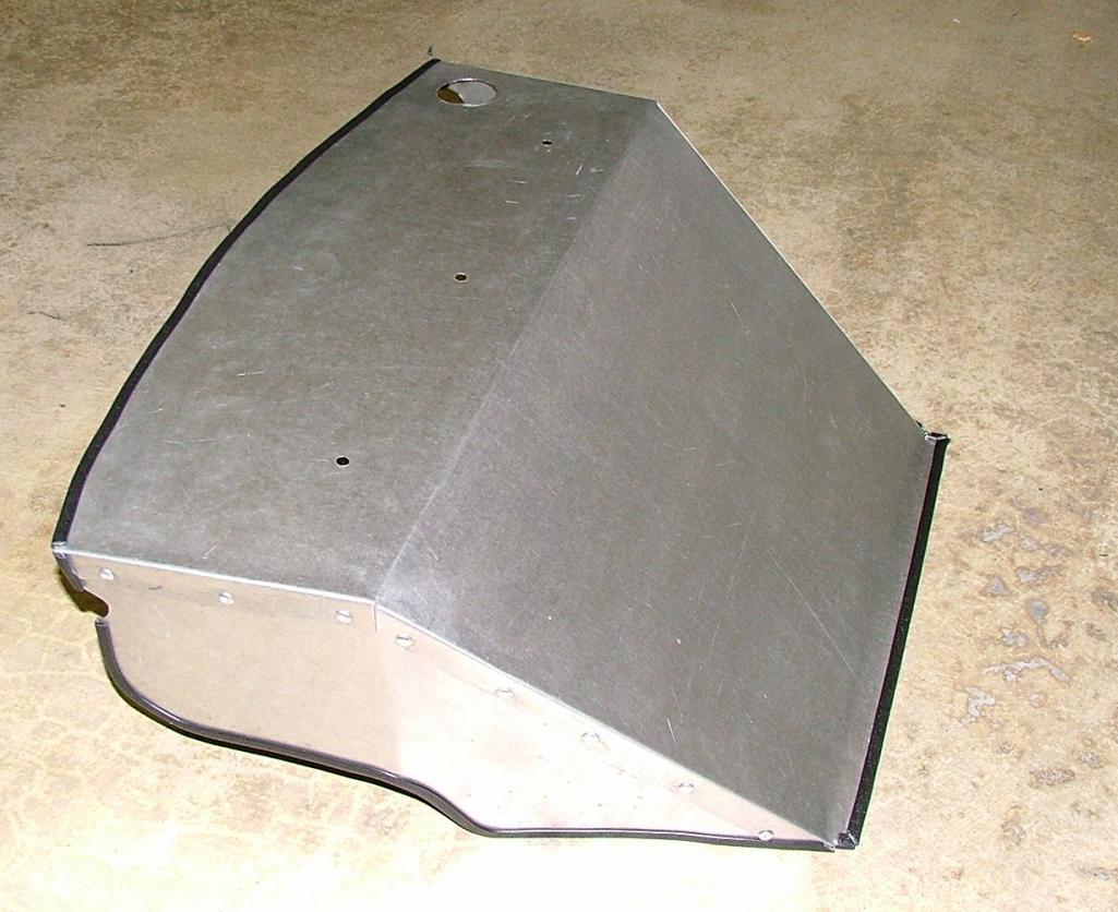

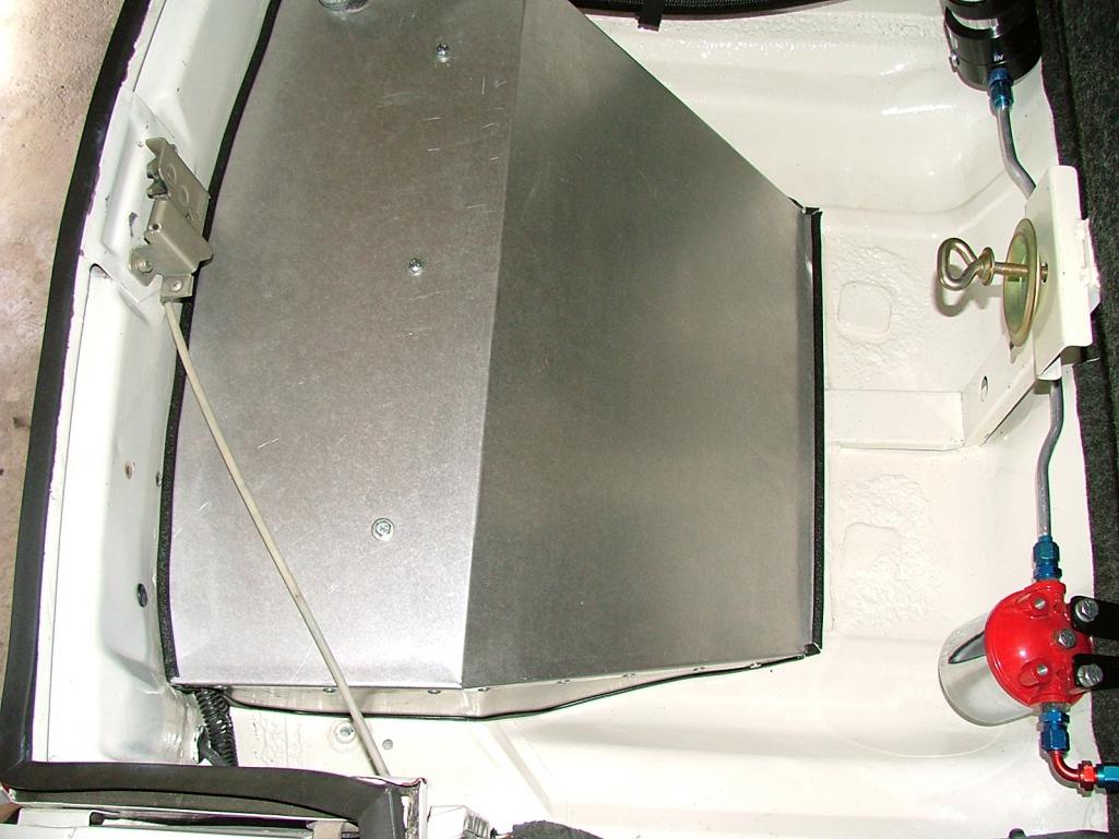

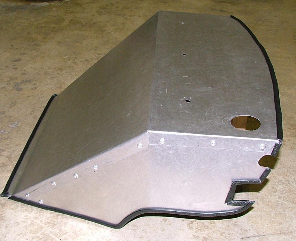

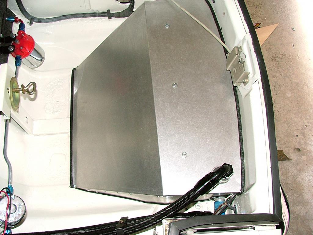

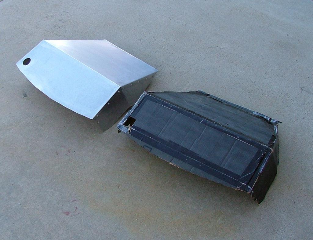

Lucky9146   To continue on with the front trunk, oil cooler, a...   Aug 8 2015, 12:29 AM
Lucky9146   The PO installed oil cooler and card board mock up...   Aug 8 2015, 12:41 AM
Lucky9146   So I started with the mock up and some spare galva...   Aug 8 2015, 01:09 AM
