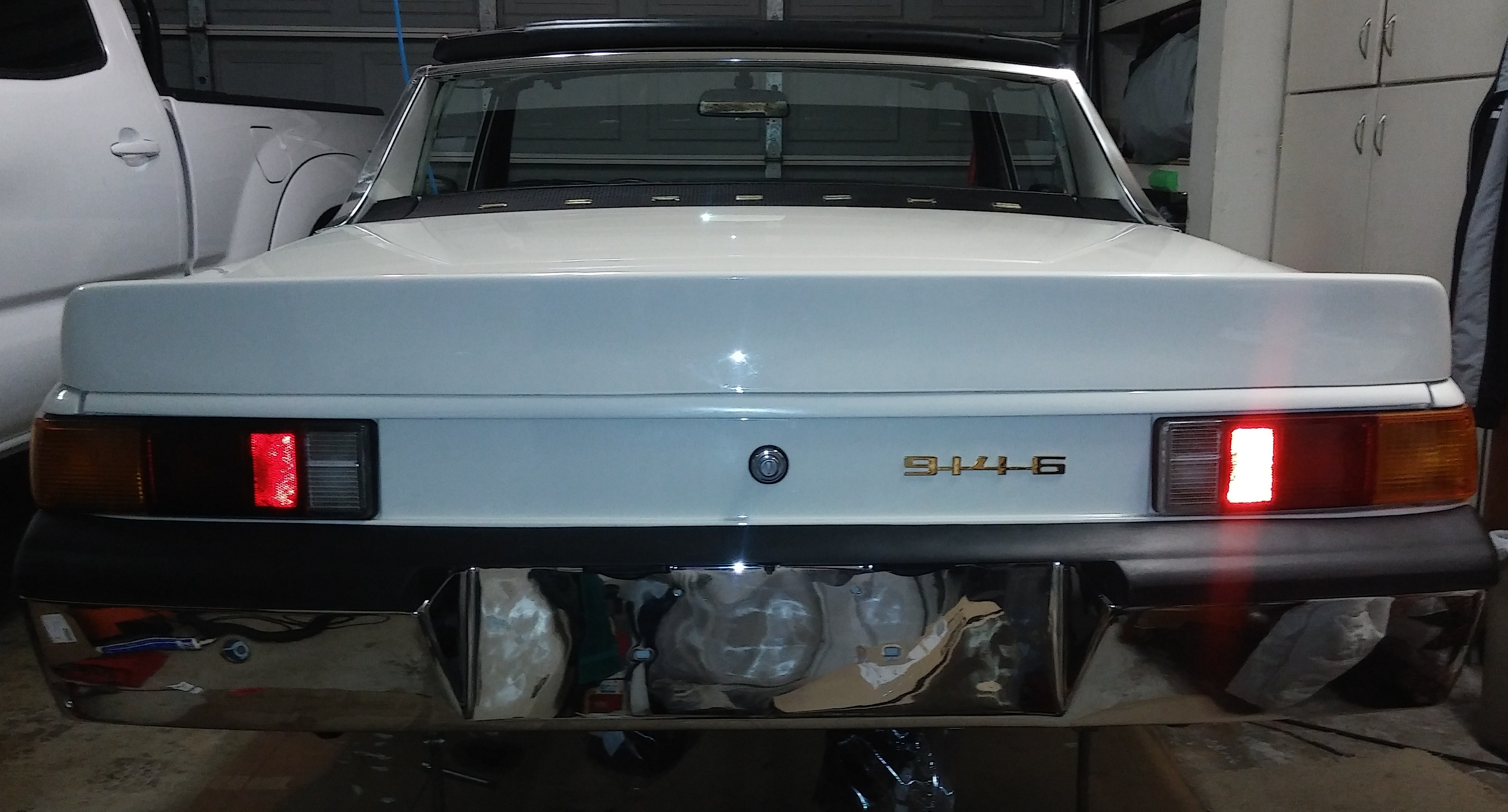

One of the things I have completed is the rear bumper. The car came with a nicely pianted (black) later style rear bumper. The PO was going down the path of black bumpers front and rear. So the car also came wih a fiberglass GT front bumper and matching lower fiberglass valance with the cut out for the cooler.
I really wanted chrome bumpers front and back so I proceded to find a nice early rear and get it chromed. Finding good local chrome shop in San Diego is the challange. I found Escondido Plating and Don does triple chrome great quality for a reasonable price. Also note I bought the new gold 914-6 script and new bumper top.
The front bumper is in work now and another story but it will be steel and chrome.

earossi
post Aug 8 2015, 08:26 AM
Posts: 210
Joined: 8-December 11
From: Chicago, Il
Member No.: 13,878
QUOTE(Lucky9146 @ Aug 6 2015, 10:10 AM) *
QUOTE(lonewolfe @ Aug 5 2015, 11:50 PM) *
QUOTE(Lucky9146 @ Aug 5 2015, 11:22 PM) *
Did the bumper have any dent repairs? What did they charge for the work?
The bumper did have one small dent and the total was $350 which I thought was reasonable for a local So Cal shop.
I got my bumpers triple plate chromed out in Salt Lake City. Both bumpers came in at a little over $700 in total. Sourcing the old bumpers was another $800; so, it's about a $1500+ mod to do it right. But, mine came out great and I would gladly spend the money on another set if I were doing another car. But, you do need to get them triple plated, meaning that a copper strike is first plated onto the bumpers. The copper will fill minor imperfections (such as corrosion pitting) and can then be sanded smooth by the plater before moving on to the nickle and chrome strikes.
Most shops just do a coat of nickle followed by chrome, which allows any pitting to show through the plating.
