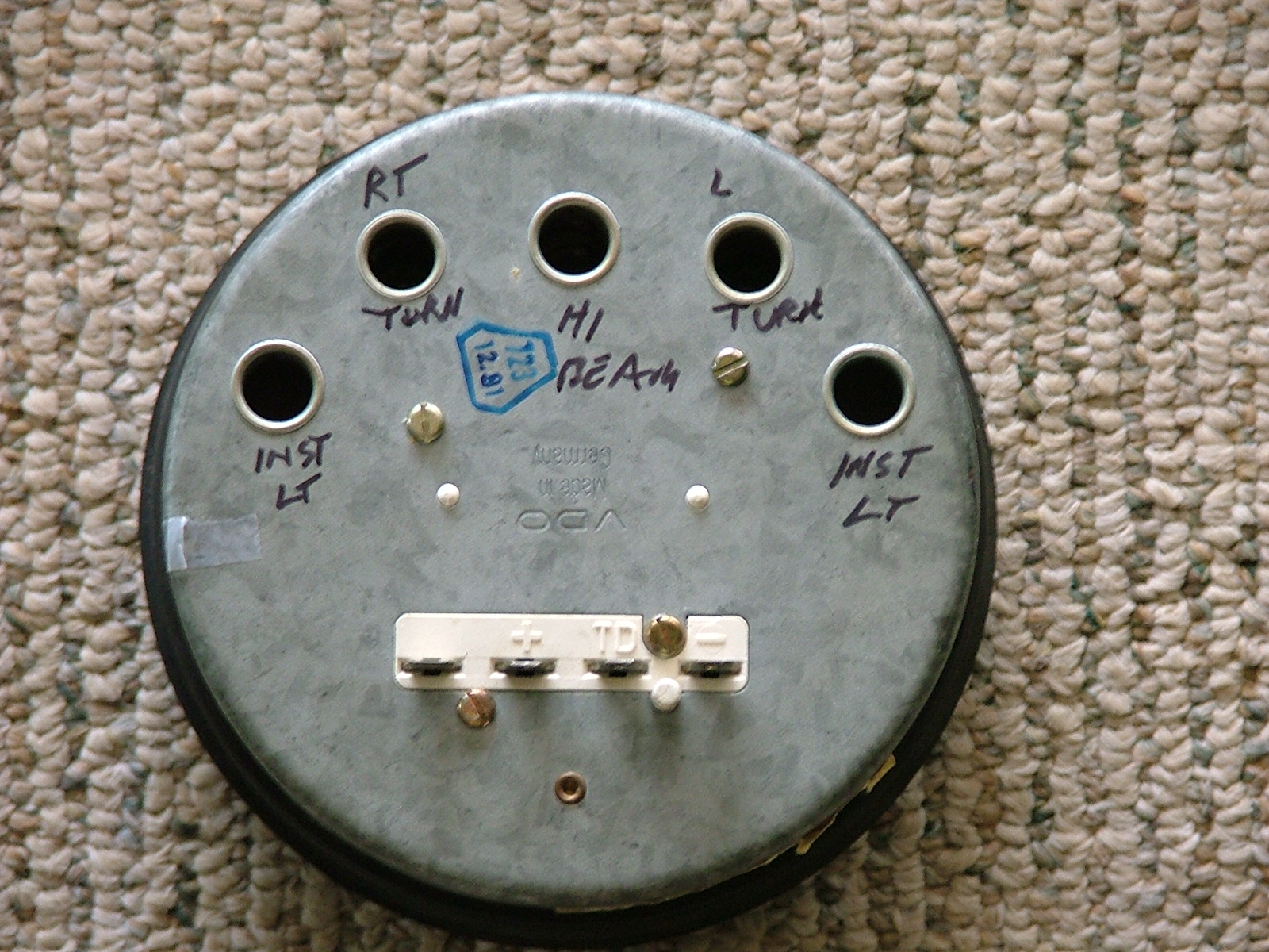

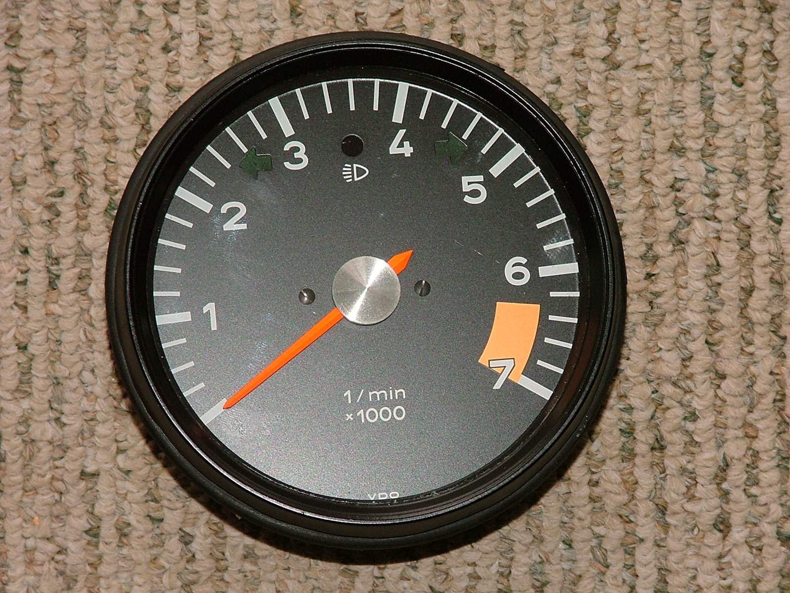

The Tach is a 911 641 303 03 which is for a 78-83 so appears appropriate for my 79 engine. It was rebuilt by North Hollywood Speedometer. One difference on the Tach from the 4 cyl (that I do not have to actually look at) is that the 4 cyl had a single turn signal light that blinked whether you turn left or right (just like an old VW) and now the the 6 cyl tach has two seperate bulb locations for left and right so of course the wiring does not support that. Delima #one just hook up two bulbs and let them both blink when turing or figure out where to bring wires up for true left and right blinking? Dunno.
