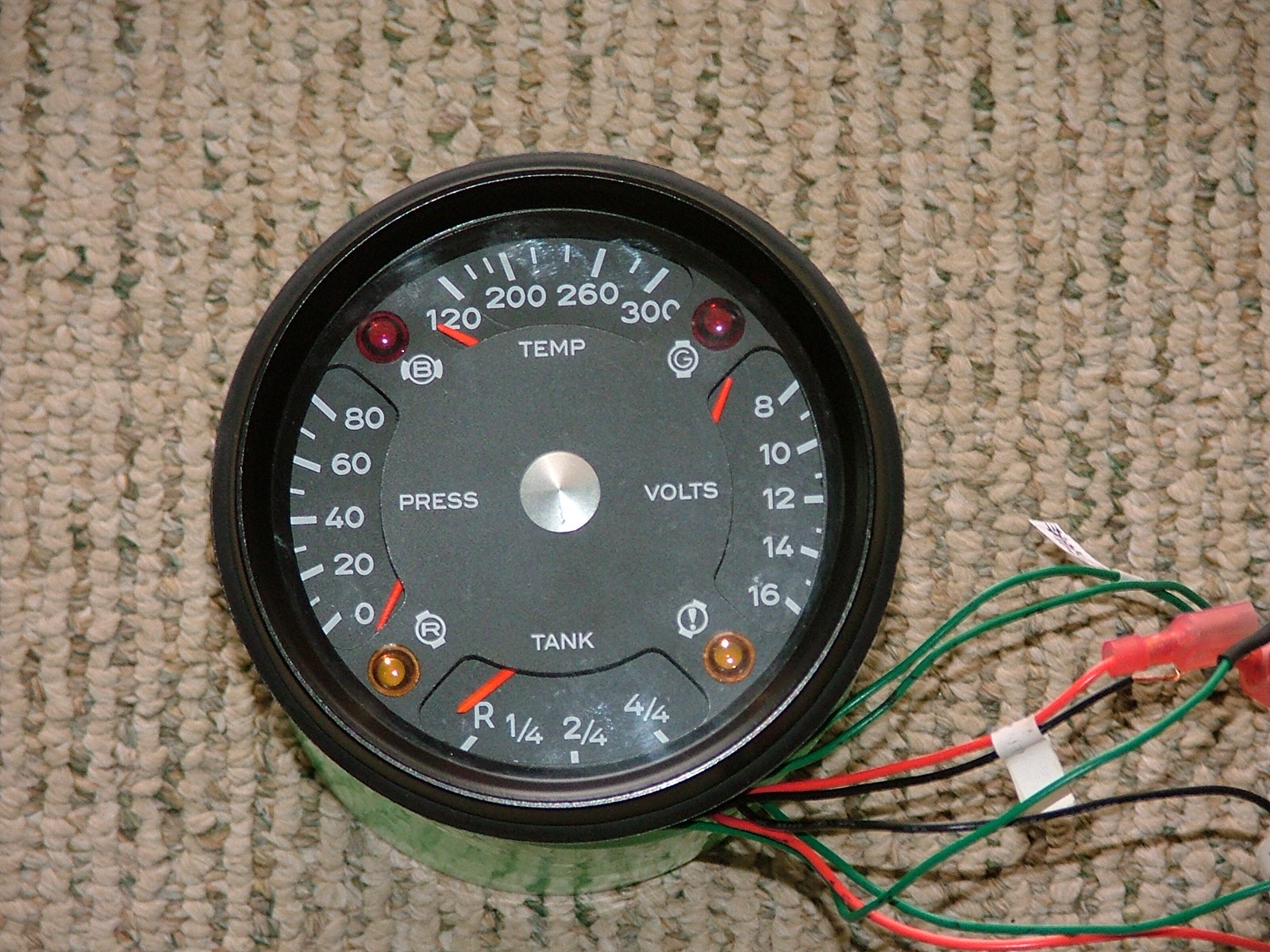

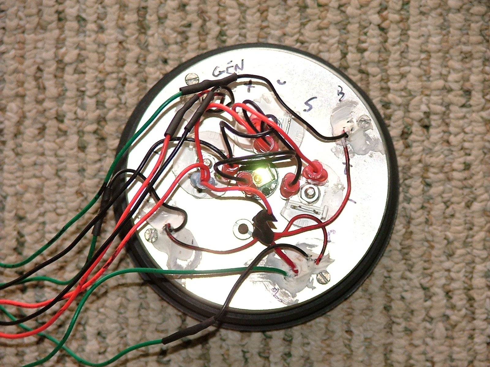

Next up is the very cool quad guage custom built for PO by New Vintage Guages in Detroit MI. It has Oil Press, Temp, Fuel, Volts. Actually it also has 4 warning lights as well. I have a buddy with a 914-6 clone who wants to kill me for it and get rid of his console, so I get why the console is gone. Much better to look at the quad guage than down at the console. As mentioned in the recent "elephant in the room post" this car had a console with gages (all gone) and a wad of cut wires that went to it. So I have figured out some from the console for the quad guage but now with the 6 conversion and different sending units it is a stretch to figure out what goes to what and this is where the wiring diagram falls apart.

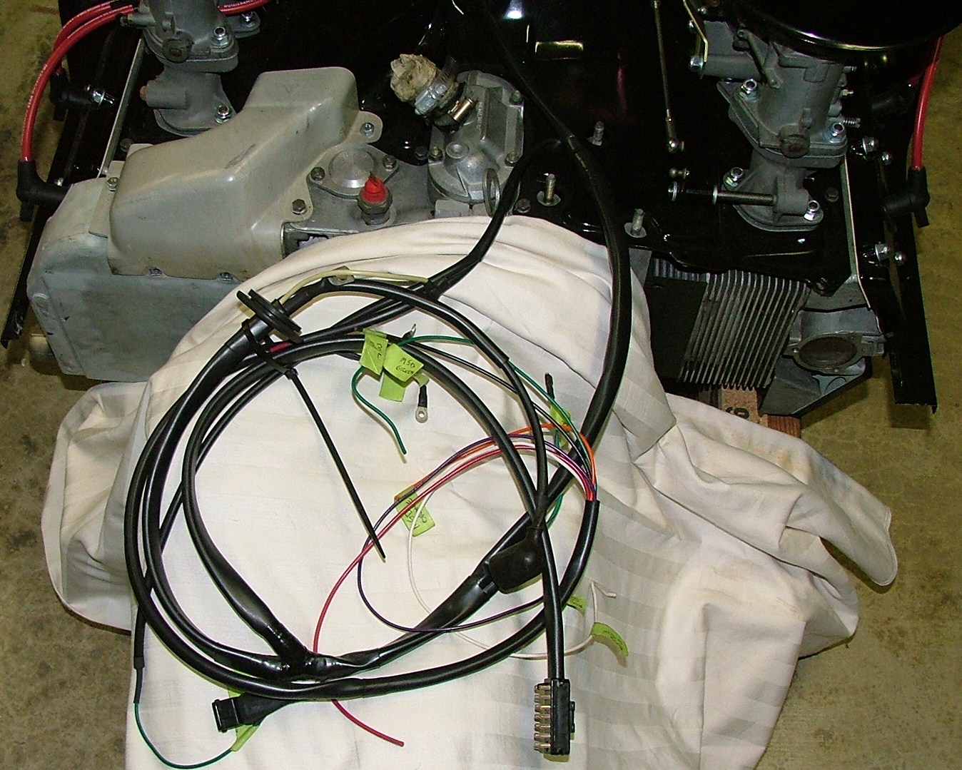

Oh, and forgot to mention engine came with PO installed Perry Kiel 914-6 engine conversion wiring harness which is very nice and clean and marked.
