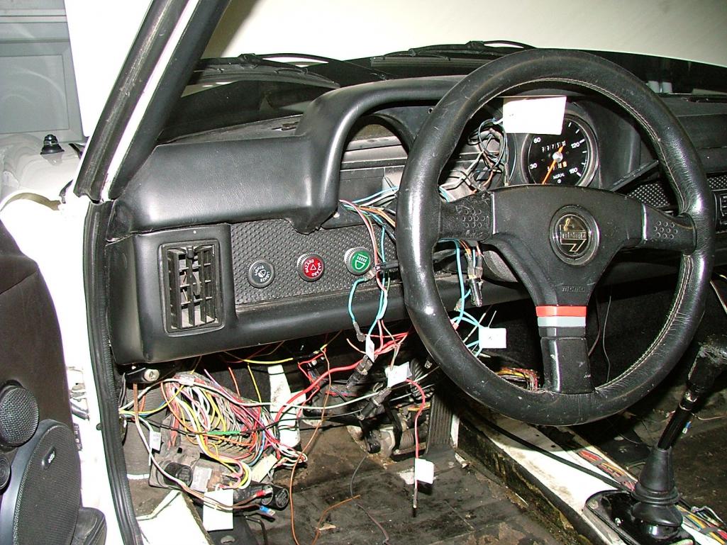

The real elephant in the room for me is the wiring for and under the dash. As I mentioned earlier in the thread, mechanically I am ok but electrical not so much. I have spent countless hours under the dash so far tracking and identifying wires from the fuse panel making some headway. Bought diagram's from Prosperos Garage and if you haven't seen them they are done very well and reasonably priced about $20. There is a lot of extraneous wires from a major bundle that were cut cut to the gone console, wires for a stereo, wires from some sort of long gone alarm system, wires to the electric and heated mirrors, and wires that used to go to the 4 cylinder engine for something(?). Add to that the PO found a 6 cyl tach (no year identified) and a really cool quad guage made both yet to be installed and challenges for both. PO bought and included small aux fuse box intended for the oil cooler fans, electric fuel pump, and whatever else. PO also included and intended to change the old main fuse panel to the modern fuses. Don;t get me wrong I think the harness is OK I think it worked but after reading a post the other day from a guy who fried his wires TWICE! I am just a bit skiddish. First the dash current state.

I can't help but laugh @ your comments ,I'am doing the exact same job as you right now,PO had just popped the gauges in the dash on my car the only thing hooked up was the speedo cable (IMG:style_emoticons/default/sad.gif) .
My combo gauge is a 77 911 one and I have standalone fuel gauge already wired in the dash,its certainly a lot of wires to play with,I spent an hour and marked them all from the Bowlby diagram,like me you will have to run extra wires for earths and backlighting etc for the combo gauge.
I will watch and maybe learnt from your mistakes/success (IMG:style_emoticons/default/biggrin.gif) (IMG:style_emoticons/default/biggrin.gif) ,as it sounds like we both share the same electrical skills,cheers.
