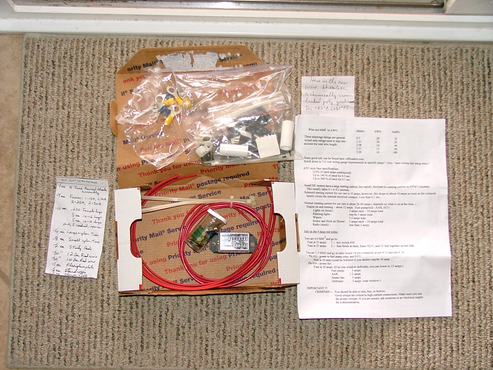

The "elephant in the room" continues by adding to the wiring "opportunity" with the concept of an aux fuse box furnished by the PO to handle the new electric fuel pump, and oil cooler fans as well as whatever else. PO had some great concepts which I agree with but looking for ideas on best location to put it aux fuse box and how to wire it in for my application. Kit form with all the afore mentioned is a lot!
Along with that is the the PO idea of converting to modern day fuses with a furnished brand new fuse panel. Thinking I need to just get it running first with old fuse panel and not add any more complexity to the issue. This is JWest clone made by Engman I believe.
Pro's Con's suggestions are welcome.

Lucky9146   The real elephant in the room for me is the wiring...   Aug 9 2015, 11:49 AM
porschetub   The real elephant in the room for me is the wirin...   Aug 9 2015, 12:46 PM
Lucky9146   I can't help but laugh @ your comments ,I...   Aug 9 2015, 01:13 PM

Lucky9146   The "elephant in the room" continues by ...   Aug 9 2015, 01:37 PM
porschetub   The "elephant in the room" continues by...   Aug 12 2015, 02:05 AM
Lucky9146   The "elephant in the room" continues b...   Aug 17 2015, 11:27 AM
