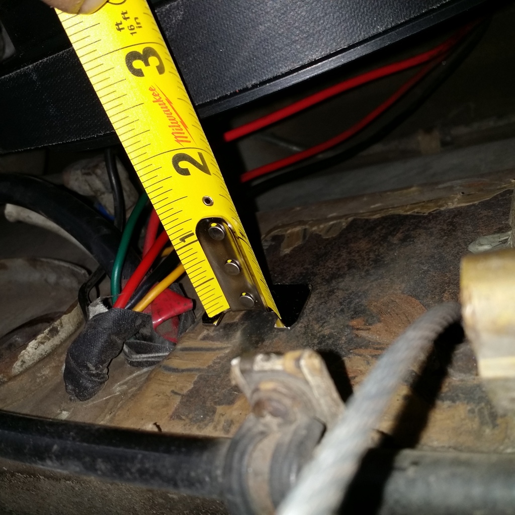

timothy_nd28   How about a pic showing the clearance between the ...   Aug 11 2015, 10:59 AM
1stworks   http://www.914world.com/bbs2/uploads_offsite/i1315...   Aug 11 2015, 11:47 AM
1stworks   Didn't remove front or sides of engine tins. M...   Aug 11 2015, 11:51 AM
