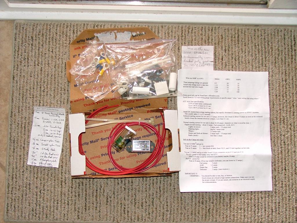

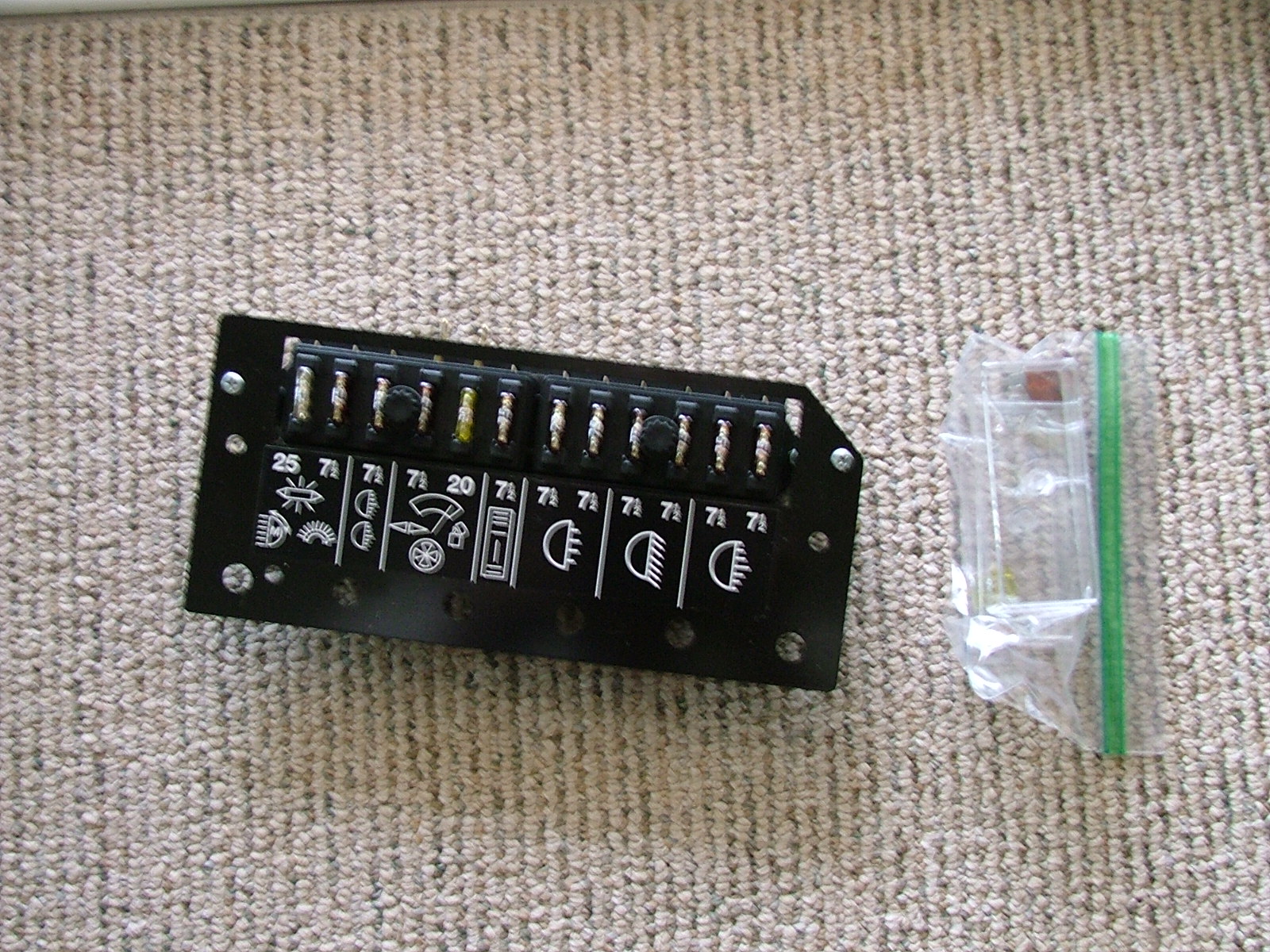

The "elephant in the room" continues by adding to the wiring "opportunity" with the concept of an aux fuse box furnished by the PO to handle the new electric fuel pump, and oil cooler fans as well as whatever else. PO had some great concepts which I agree with but looking for ideas on best location to put it aux fuse box and how to wire it in for my application. Kit form with all the afore mentioned is a lot!
Along with that is the the PO idea of converting to modern day fuses with a furnished brand new fuse panel. Thinking I need to just get it running first with old fuse panel and not add any more complexity to the issue. This is JWest clone made by Engman I believe.
Pro's Con's suggestions are welcome.
Since you have the fuseboard put it in ,they seem to get good press,however I would leave it till later as you suggested.
Did you find your other indicator switch lamp wire?my missing one was tucked down the far left hand side near the headlight switch wiring,I think it was a black/green or similar this one is for the RH side.
Have you a wire for your oil pressure gauge? I foolishly run new wiring into the engine space and forgot this one....bugger.
In regards to your aux fuse box,i think they are a good idea,I ran a new 30amp rated cable for future amp and others devices and have a nice little 4 fuse block I intent to tuck up under the dash.
