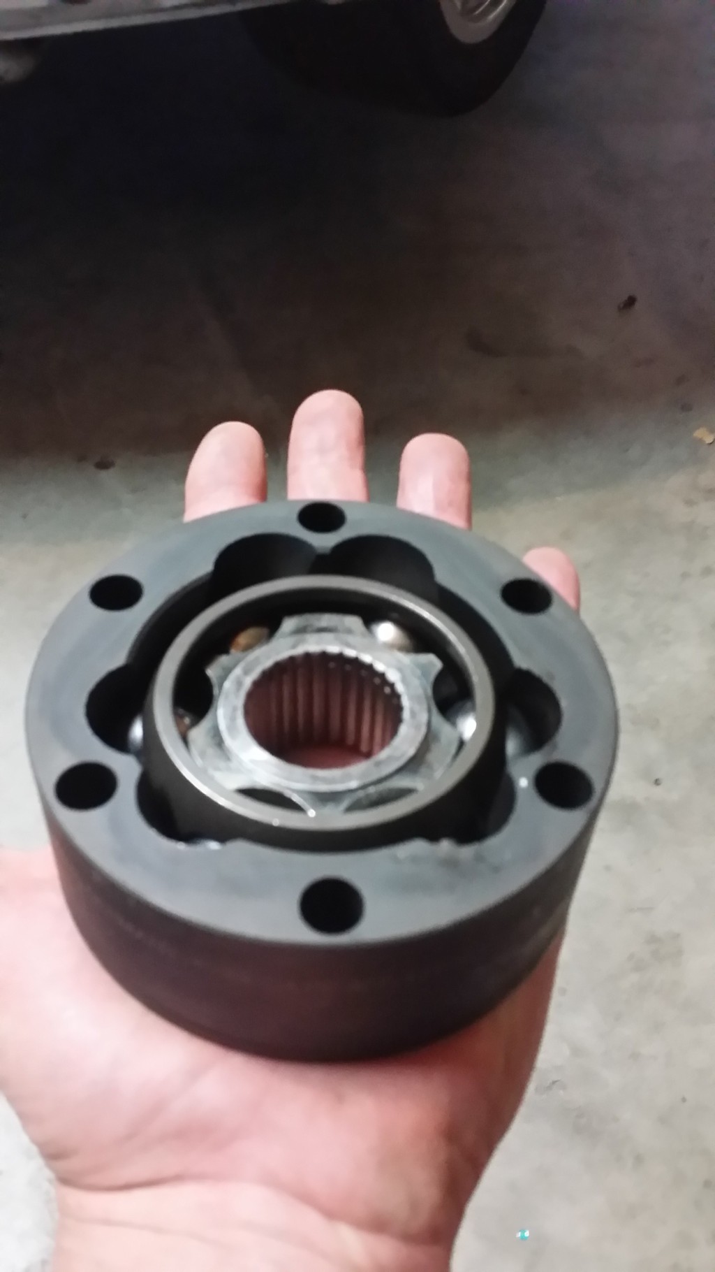

Good progress on axles today.Found shop in town that can do complete
Cv's.I got 930 108mm inner and 100mm outer cv's today.Going to mount
Them up tomorrow and get measurements.
(IMG:http://www.914world.com/bbs2/uploads_offsite/i1315.photobucket.com-15718-1439519248.1.jpg)
(IMG:http://www.914world.com/bbs2/uploads_offsite/i1315.photobucket.com-15718-1439519249.2.jpg)
(IMG:http://www.914world.com/bbs2/uploads_offsite/i1315.photobucket.com-15718-1439519249.3.jpg)
