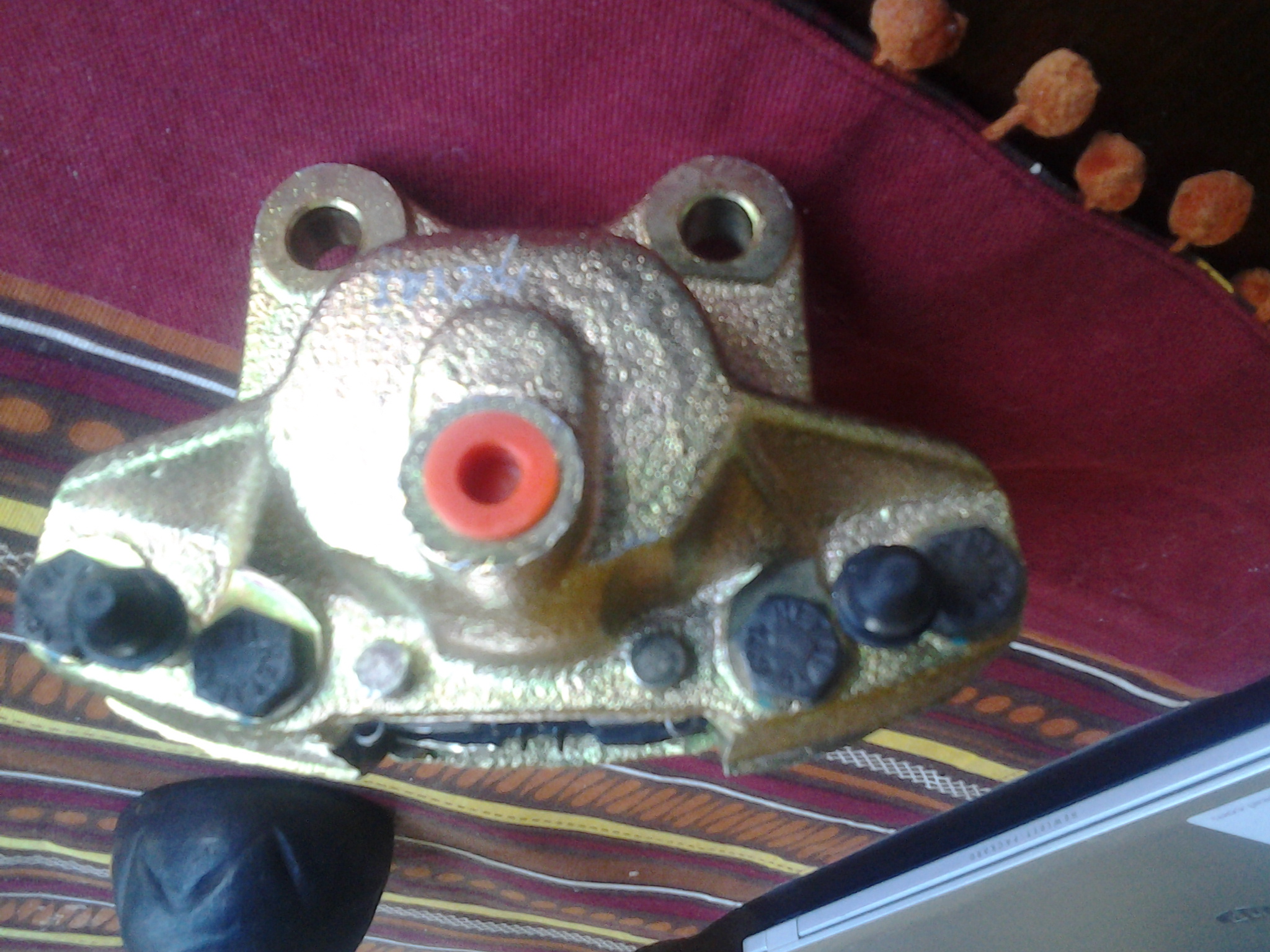

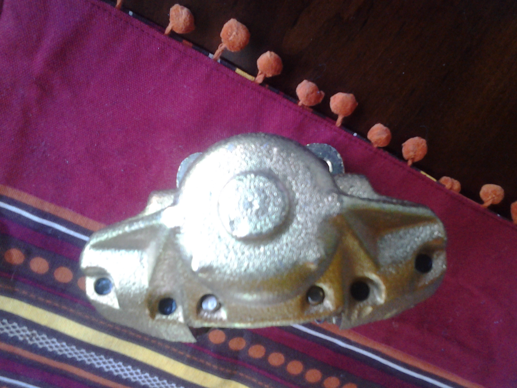

Hi everyone, I ordered a new caliper off ebay, for the front left. I got a call from the mechanic that it doesnt fit, and the bolts at the bottom are farther apart. I talked to the seller, and he said that there is nothing wrong and it should fit fine. The original caliper says vw 42 on it, im guessing its 42mm bore? Whos right, the mechanic, or the seller? Could the brakes be from a different car? Thanks,

mepstein Doesn't look like a 914 caliper. Aug 16 2015, 04:52 PM
max72914
The new one... Aug 16 2015, 05:16 PM
era vulgaris Your new caliper looks a lot like the ones I put o... Aug 16 2015, 05:57 PM
max72914
Your new caliper looks a lot like the ones I put ... Aug 16 2015, 07:33 PM
max72914
Your new caliper looks a lot like the ones I put ... Aug 16 2015, 07:34 PM
Spoke
Tip: don't buy parts from ebay
:agree:
... Aug 17 2015, 11:31 AM
max72914 You can PM Eric at Eric_Shea.
And/Or go to his we... Aug 17 2015, 12:38 PM
mgp4591 Paging Mr. Shea, Mr. Eric Shea... you have a call ... Aug 16 2015, 07:06 PM
stugray The shiny new caliper looks like a Late caliper. (... Aug 16 2015, 11:01 PM
Dave_Darling First question: Do you have five-lug wheels?
Sec... Aug 17 2015, 09:17 AM
max72914
Se... Aug 17 2015, 12:36 PM
Eric_Shea That's a Chioneese caliper. They're crap.... Aug 18 2015, 08:02 AM
