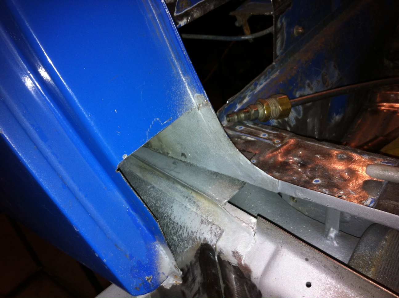

mbseto   These pics should have gone in with the last post,...   Feb 25 2018, 11:43 PM
defianty   Nice work you're doing there.   Feb 26 2018, 02:42 AM
mbseto   Nice work you're doing there. Thank you, I ...   Feb 26 2018, 10:46 PM
mbseto   Took out a little of the door frame to get those r...   Feb 26 2018, 11:15 PM
