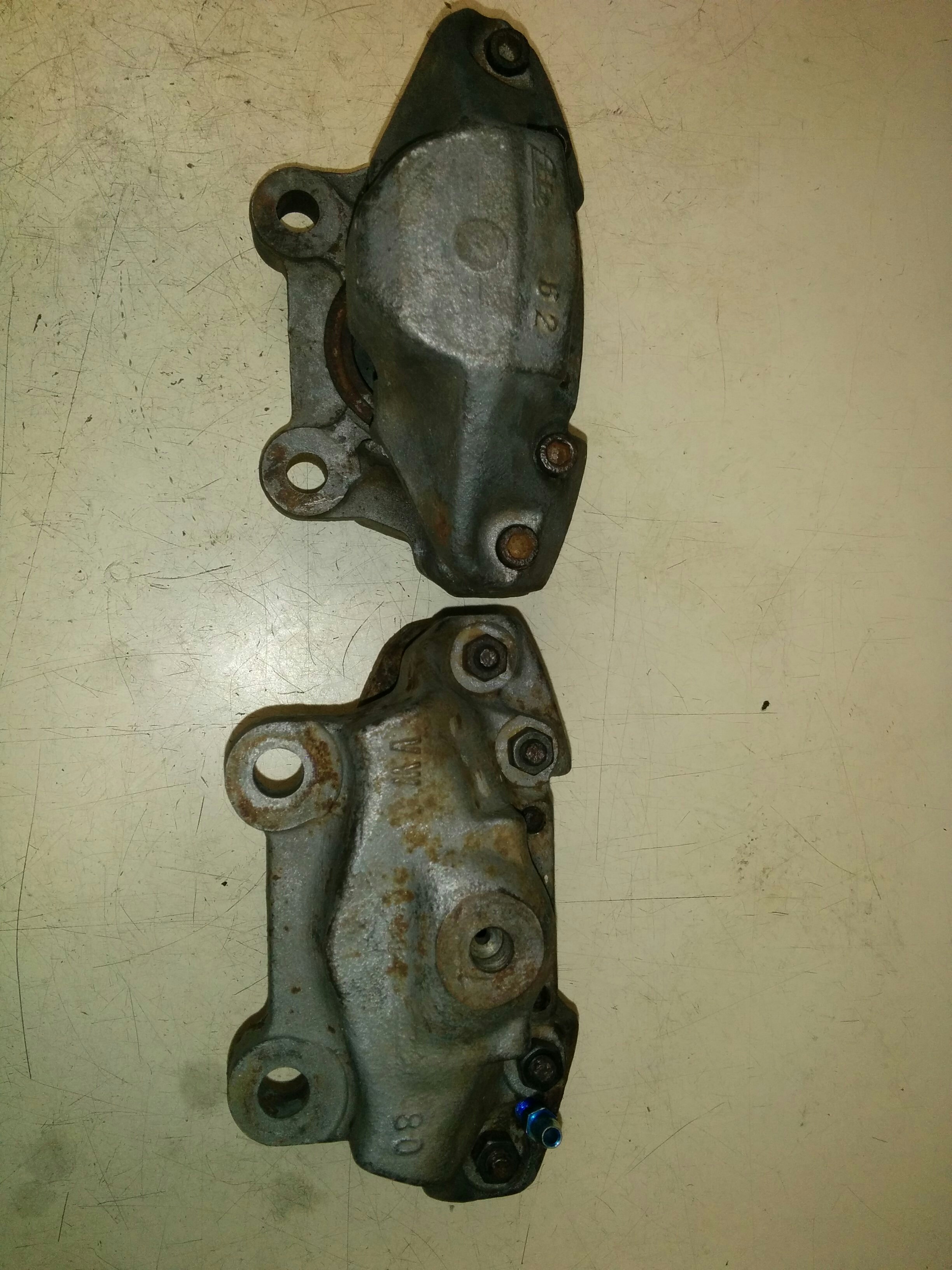

Hi everyone, I ordered a new caliper off ebay, for the front left. I got a call from the mechanic that it doesnt fit, and the bolts at the bottom are farther apart. I talked to the seller, and he said that there is nothing wrong and it should fit fine. The original caliper says vw 42 on it, im guessing its 42mm bore? Whos right, the mechanic, or the seller? Could the brakes be from a different car? Thanks,
Max Attached thumbnail(s) Attached image(s)

mepstein Doesn't look like a 914 caliper. Aug 16 2015, 04:52 PM

era vulgaris Your new caliper looks a lot like the ones I put o... Aug 16 2015, 05:57 PM

stugray The shiny new caliper looks like a Late caliper. (... Aug 16 2015, 11:01 PM
Dave_Darling First question: Do you have five-lug wheels?
Sec... Aug 17 2015, 09:17 AM

Eric_Shea That's a Chioneese caliper. They're crap.... Aug 18 2015, 08:02 AM

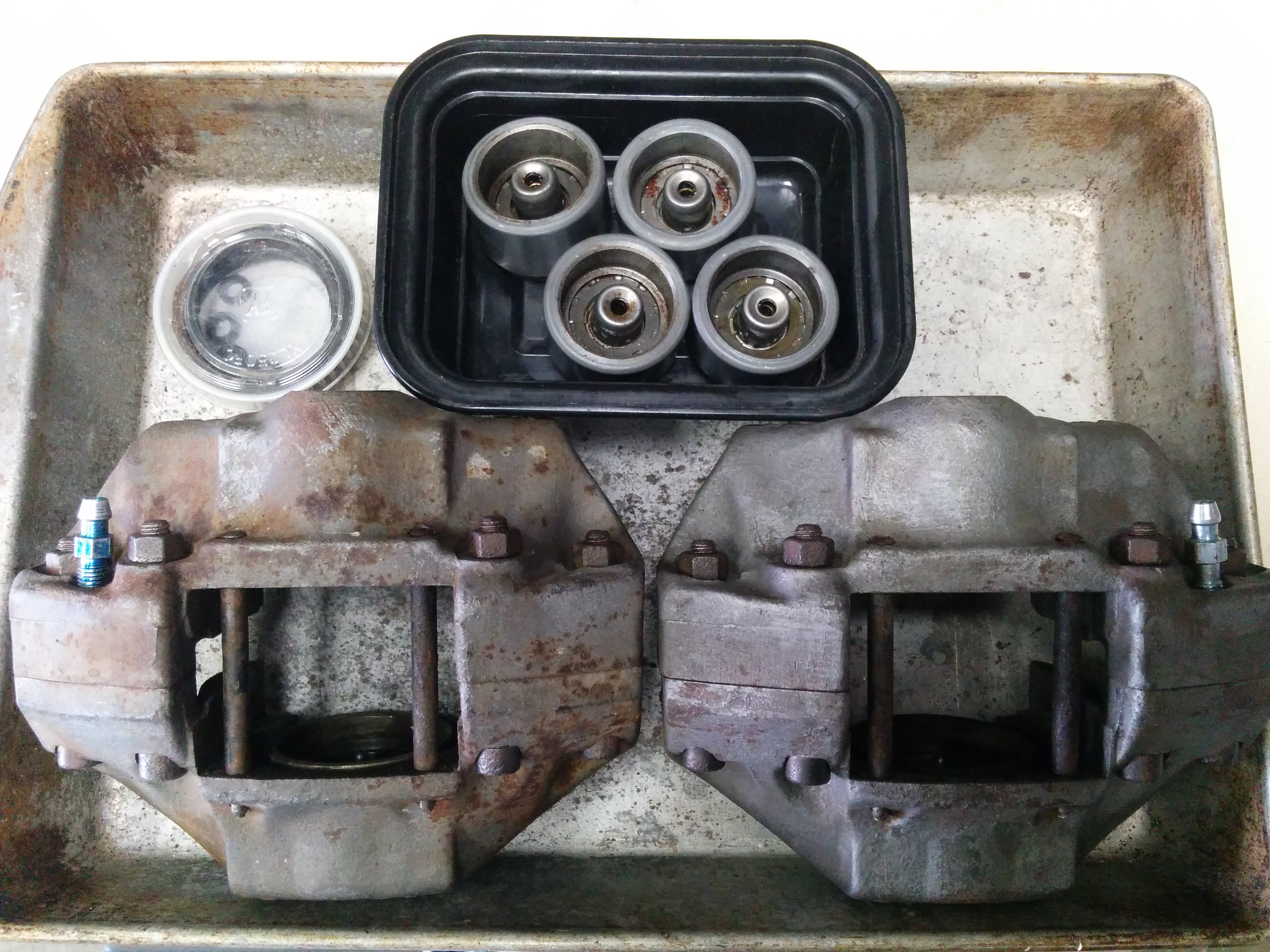

I have this pair of cores for the front if... Aug 18 2015, 10:57 AM![]() ![]() |
