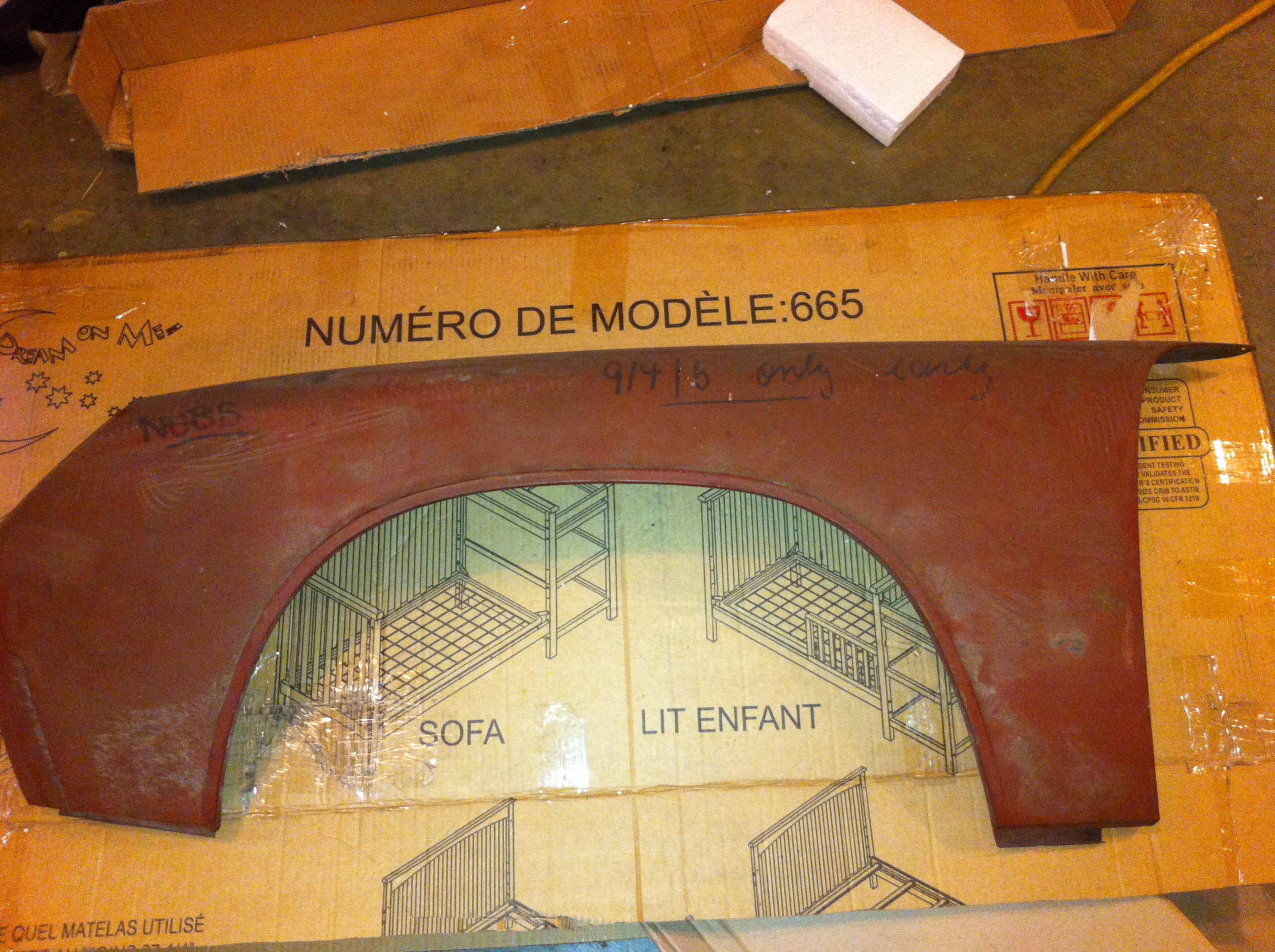

Special thank you to Peter 0396 for generously offering his factory NOS left fender. Although I never met Peter I have had the good fortune of having a couple telephone conversations with him. He is one of the strongest and most determined men I have ever had the pleasure to know.
And another guy that helped put this together and deserves a tip of the hat is Mark euro911. Mark went out of his way to collect this fender, package it up safely and get it shipped out.
Thanks to both of you! (IMG:style_emoticons/default/beerchug.gif)

No more generous than Rick. I wanted to see the alien and he ran home from a busy day and fed my entire family. I hope this build and pull goes as I am sure it will, with all of the chips sliding your way. I wanted to publicly thank you Rick but I was worried that you would be seeing hordes of teeners. Then I calculated the distance between California and Minnesota. so with that worry gone, thank you so much for the nice time. My younger son put it well. "so Dad, we are going to have dinner with someone you have never met?" Yep, and I had a great time.

rick 918-S   Special thank you to Peter 0396 for generously off...   Aug 18 2015, 05:38 PM
worn   No more generous than Rick. I wanted to see the al...   Aug 18 2015, 07:17 PM
rick 918-S   No more generous than Rick. I wanted to see the a...   Aug 18 2015, 07:40 PM
euro911   Special thank you to Peter 0396 for generously off...   Aug 18 2015, 10:19 PM
