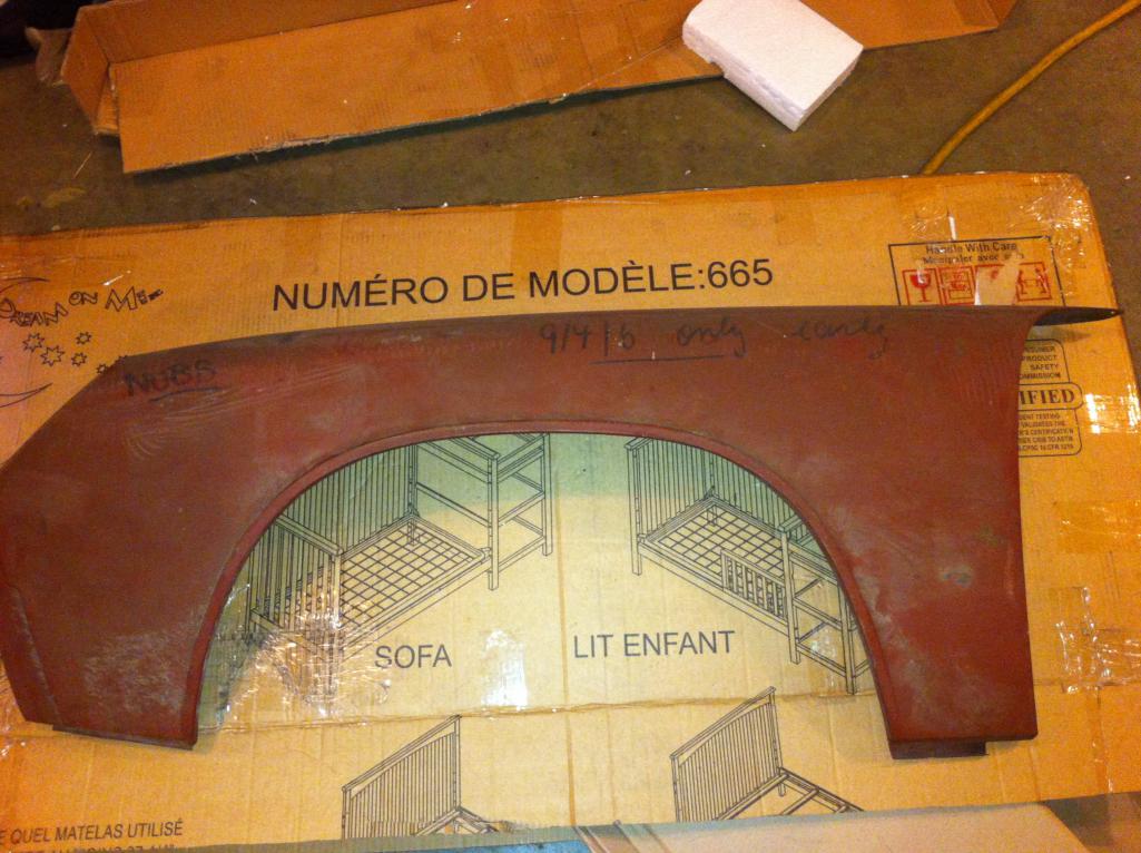

Special thank you to Peter 0396 for generously offering his factory NOS left fender. Although I never met Peter I have had the good fortune of having a couple telephone conversations with him. He is one of the strongest and most determined men I have ever had the pleasure to know.
And another guy that helped put this together and deserves a tip of the hat is Mark euro911. Mark went out of his way to collect this fender, package it up safely and get it shipped out.
Thanks to both of you! (IMG:style_emoticons/default/beerchug.gif)

QUOTE(rick 918-S @ Aug 18 2015, 04:38 PM) *
My pleasure, Rick. Glad to see the shipper didn't beat it up (IMG:style_emoticons/default/cool_shades.gif)
Keep your chin up, Peter ... and get your butt home soon (IMG:style_emoticons/default/mad.gif)

rick 918-S   Special thank you to Peter 0396 for generously off...   Aug 18 2015, 05:38 PM
worn   No more generous than Rick. I wanted to see the al...   Aug 18 2015, 07:17 PM
rick 918-S   No more generous than Rick. I wanted to see the a...   Aug 18 2015, 07:40 PM
euro911   Special thank you to Peter 0396 for generously off...   Aug 18 2015, 10:19 PM
