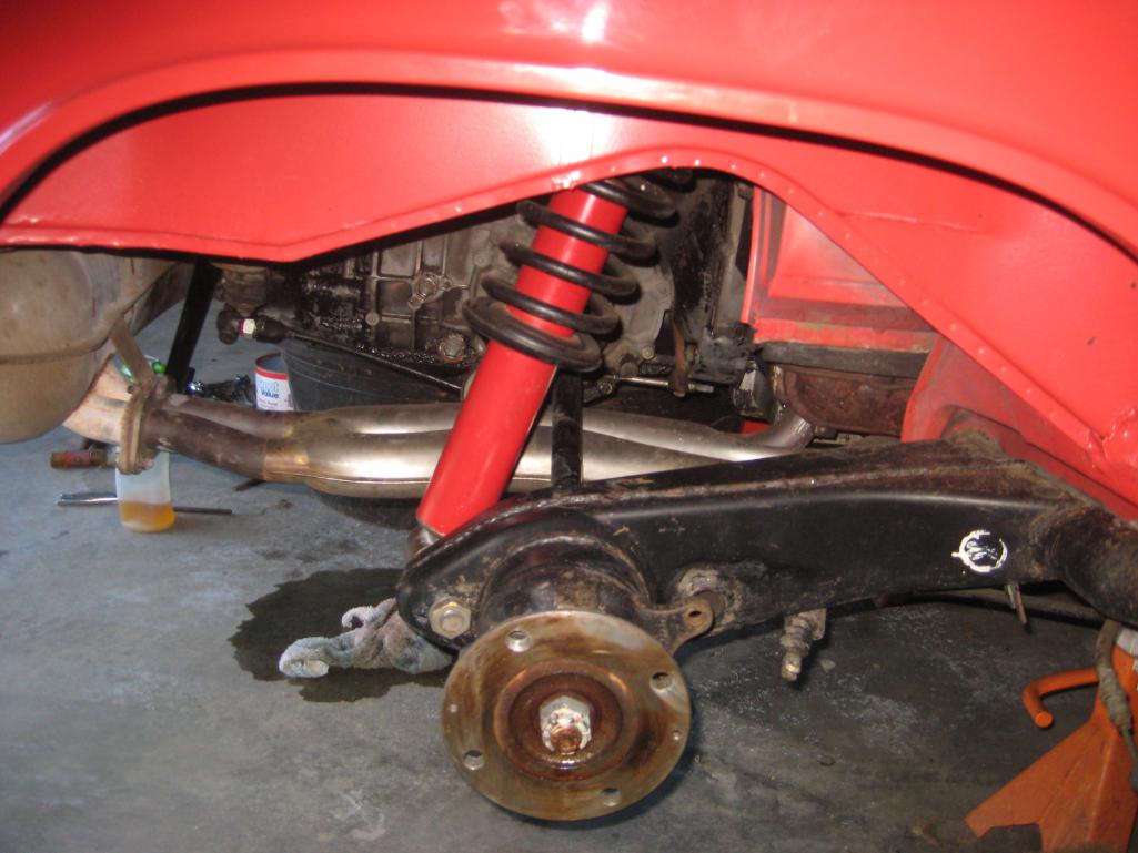

I took out my '76 and while driving I could tell there was some additional drag when I depressed the clutch pedal. I pulled over and felt the wheels, and found the driver's side rear was much warmer than the other three. So, after filling with E-free gas, I drove home and put her up on blocks.
I took the rear wheels off first, and found the driver's side rotor and caliper were essentially seized - I couldn't turn the rotor at all. Since the car is almost 40 years old, and in terrific condition otherwise, I placed an order with PMB Performance for a complete brake replacement.
I started by cleaning the wheel wells that had decades of dirt. Here is what the rear looked like:

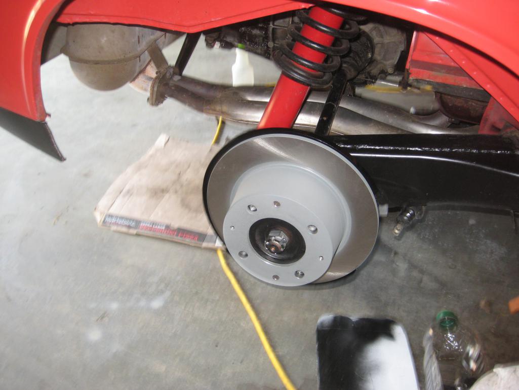

The other side.
I used some of Eastwood's Chassis Black paint to touch up the trailing arms.
I stripped the paint off the rotor guards using paint stripper followed by a 3M paint removing disc in my drill, and finally a brass wire wheel on the drill.
