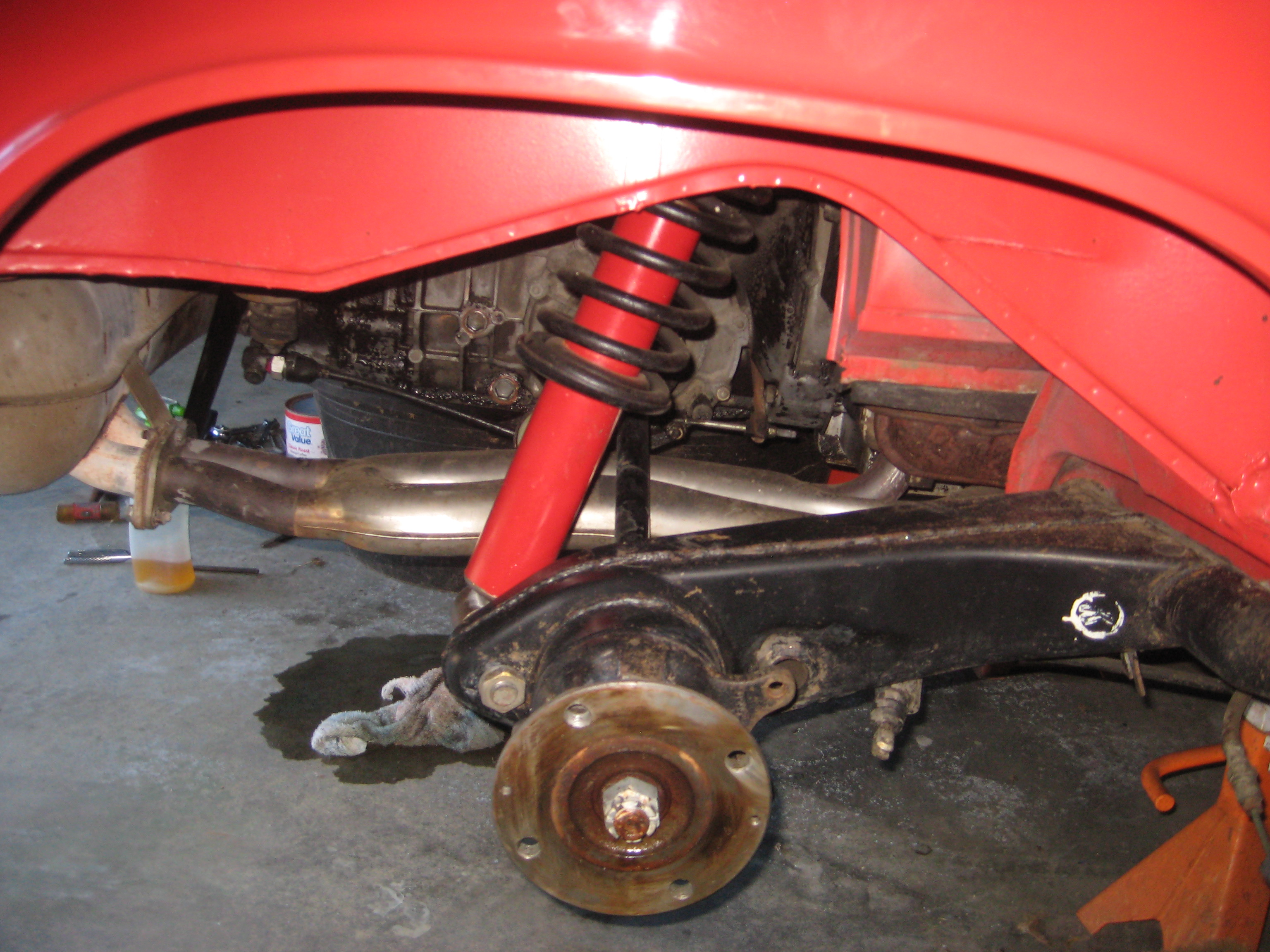

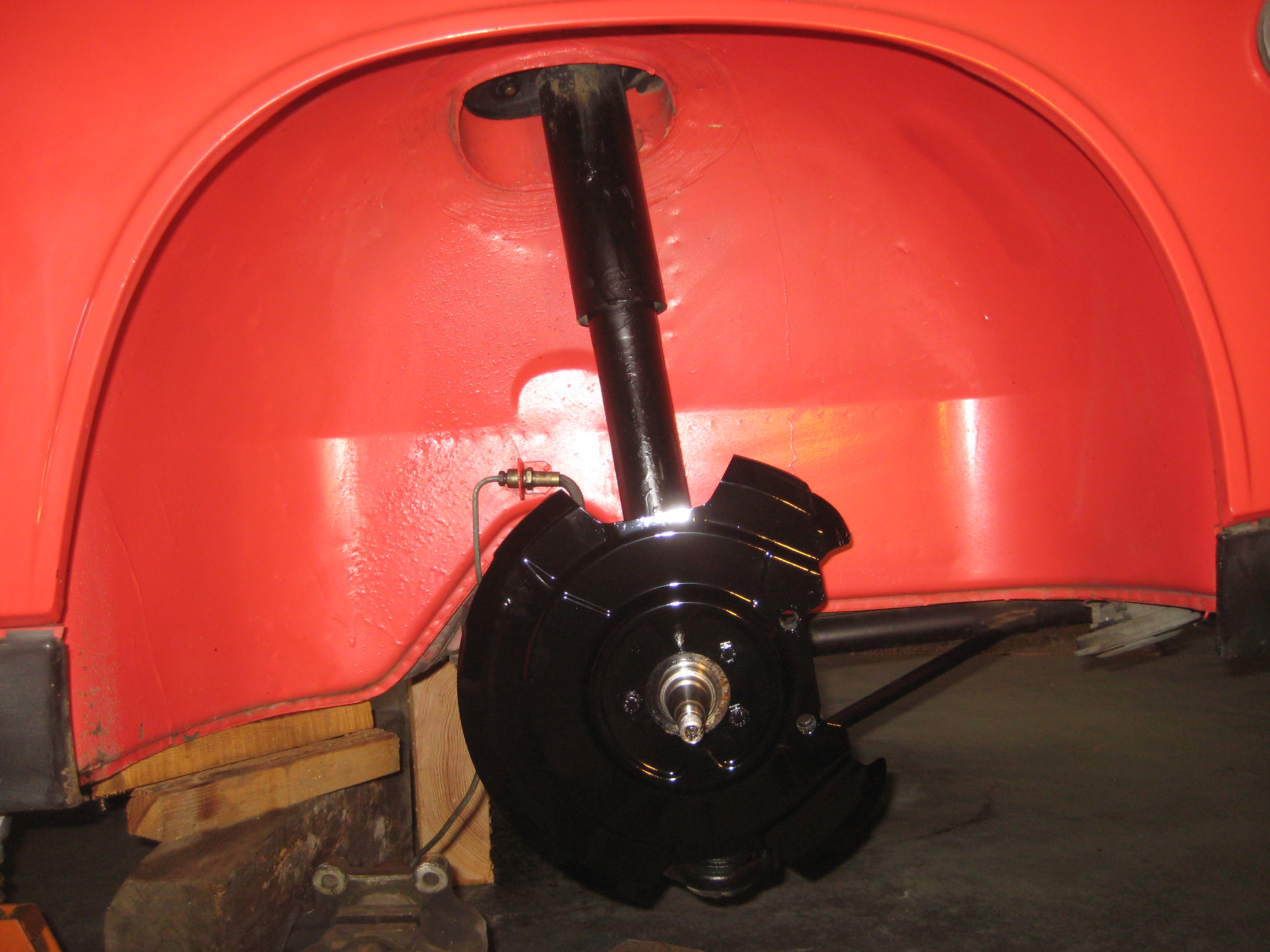

I started by cleaning the wheel wells that had decades of dirt. Here is what the rear looked like:
mikedsilva
Aug 20 2015, 08:26 PM
that wheel arch is amazingly clean!

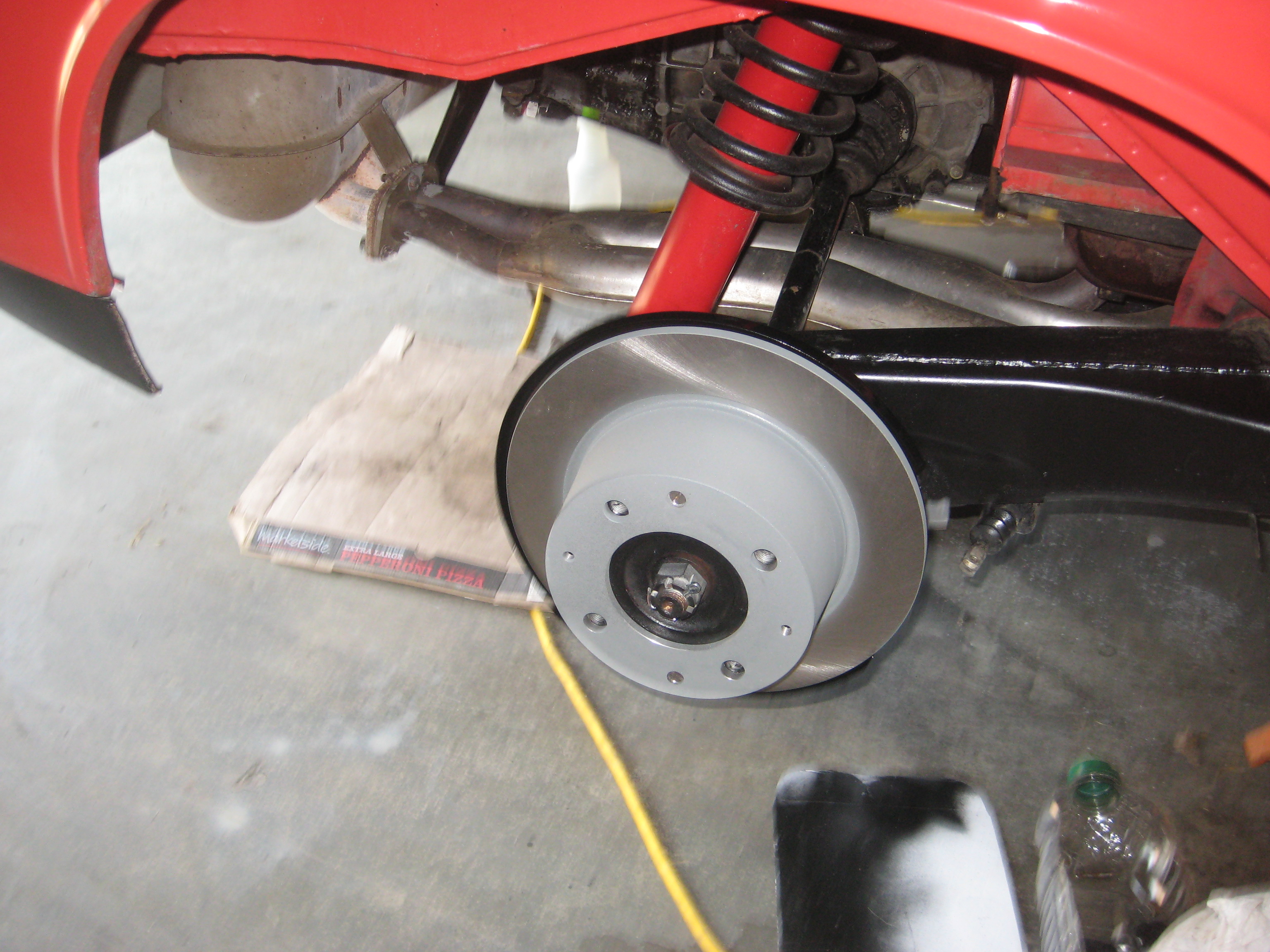

The other side.

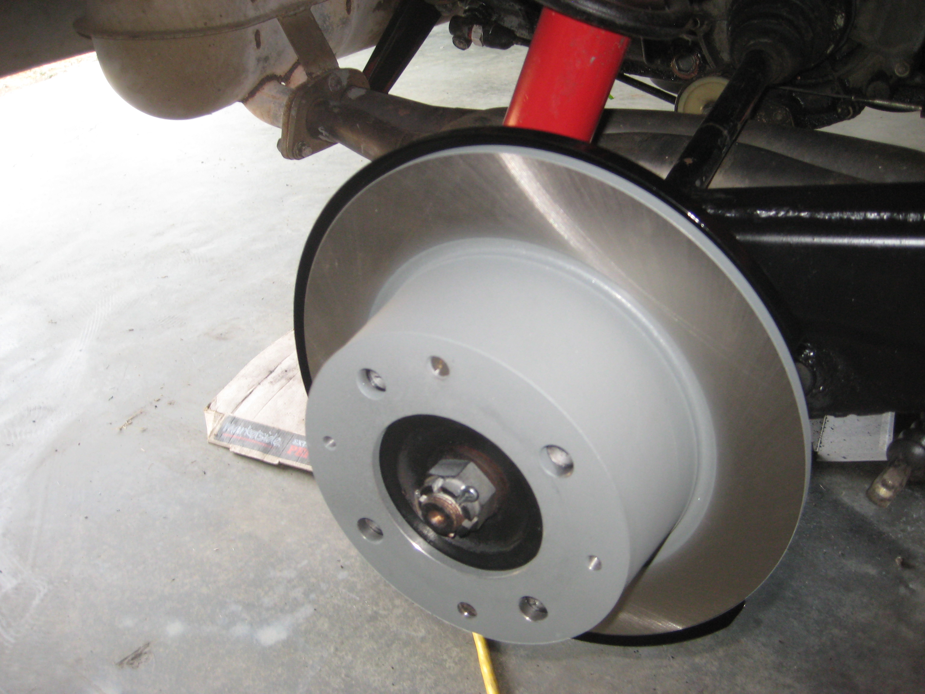

Click to view attachment I used some of Eastwood's Chassis Black paint to touch up the trailing arms.
Click to view attachmentI stripped the paint off the rotor guards using paint stripper followed by a 3M paint removing disc in my drill, and finally a brass wire wheel on the drill.

QUOTE(relentless @ Aug 20 2015, 07:41 PM)
The other side.
Click to view attachmentNew rotors really set it off. Just wait until the new brake lines and Eric's calipers are added!

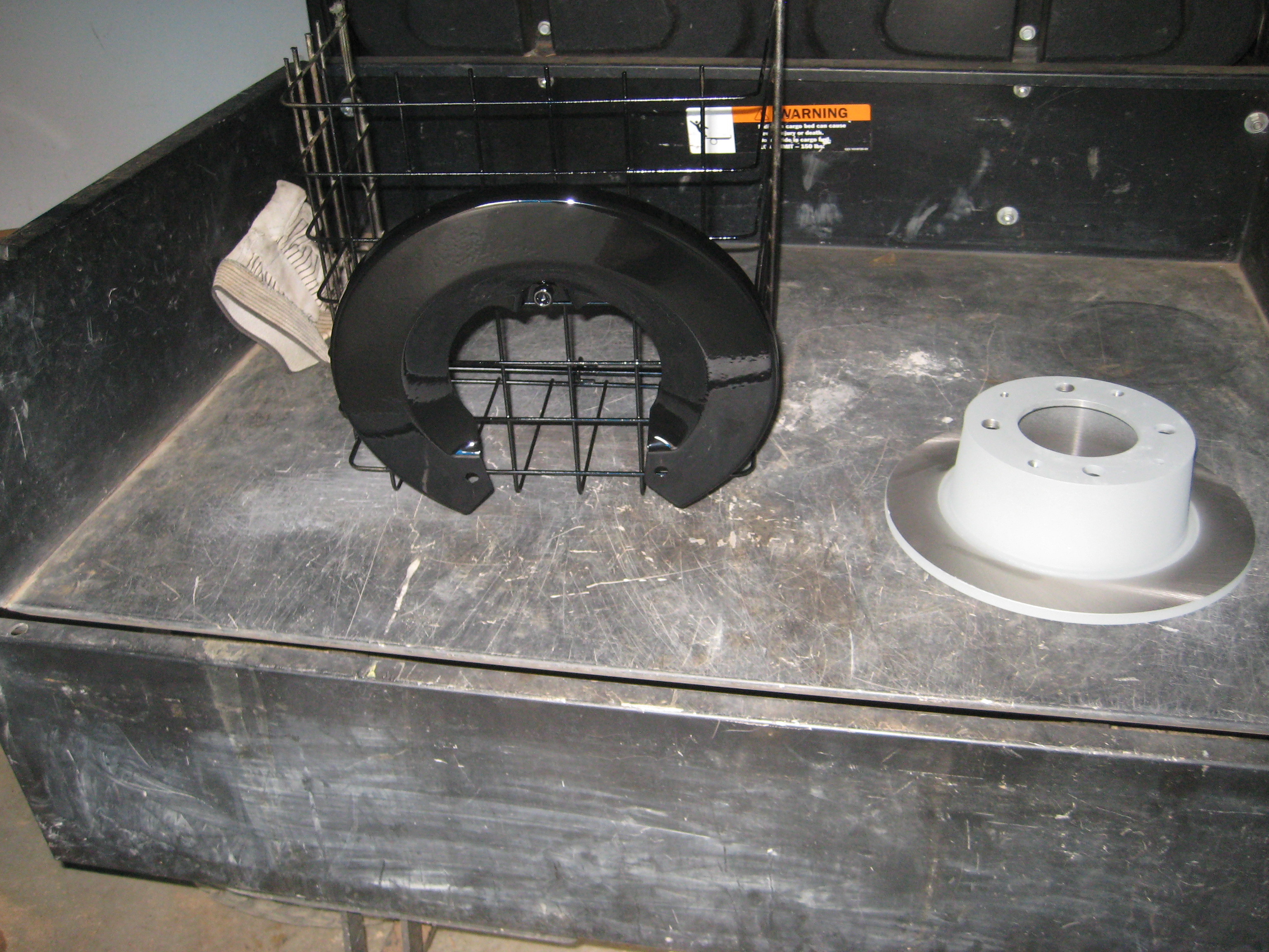

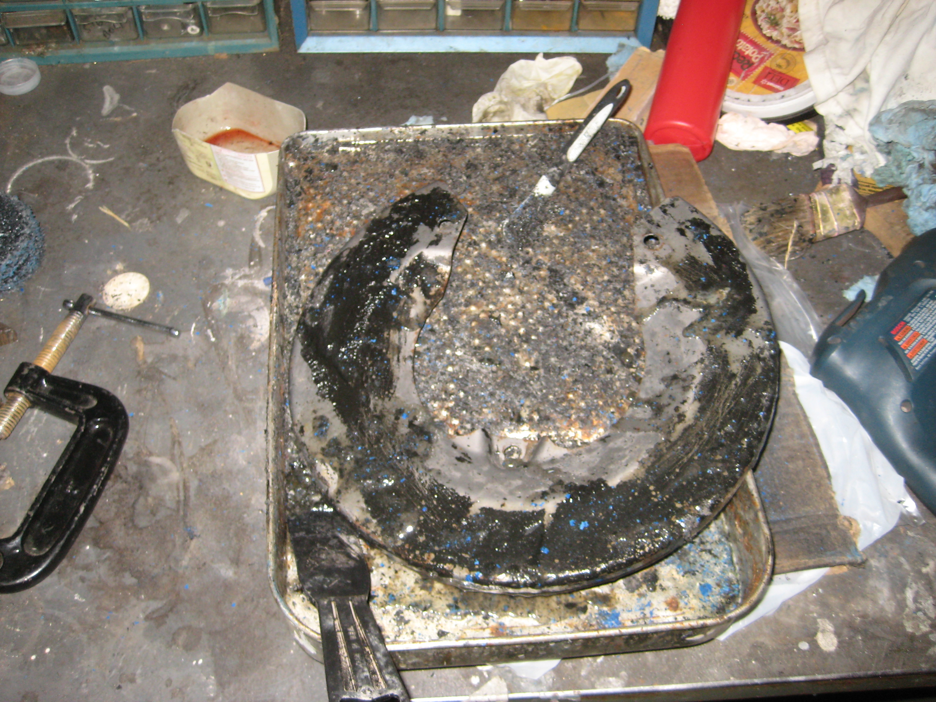

Let's try this again. Here is the disc brake guard with some paint remover helping take off the paint.

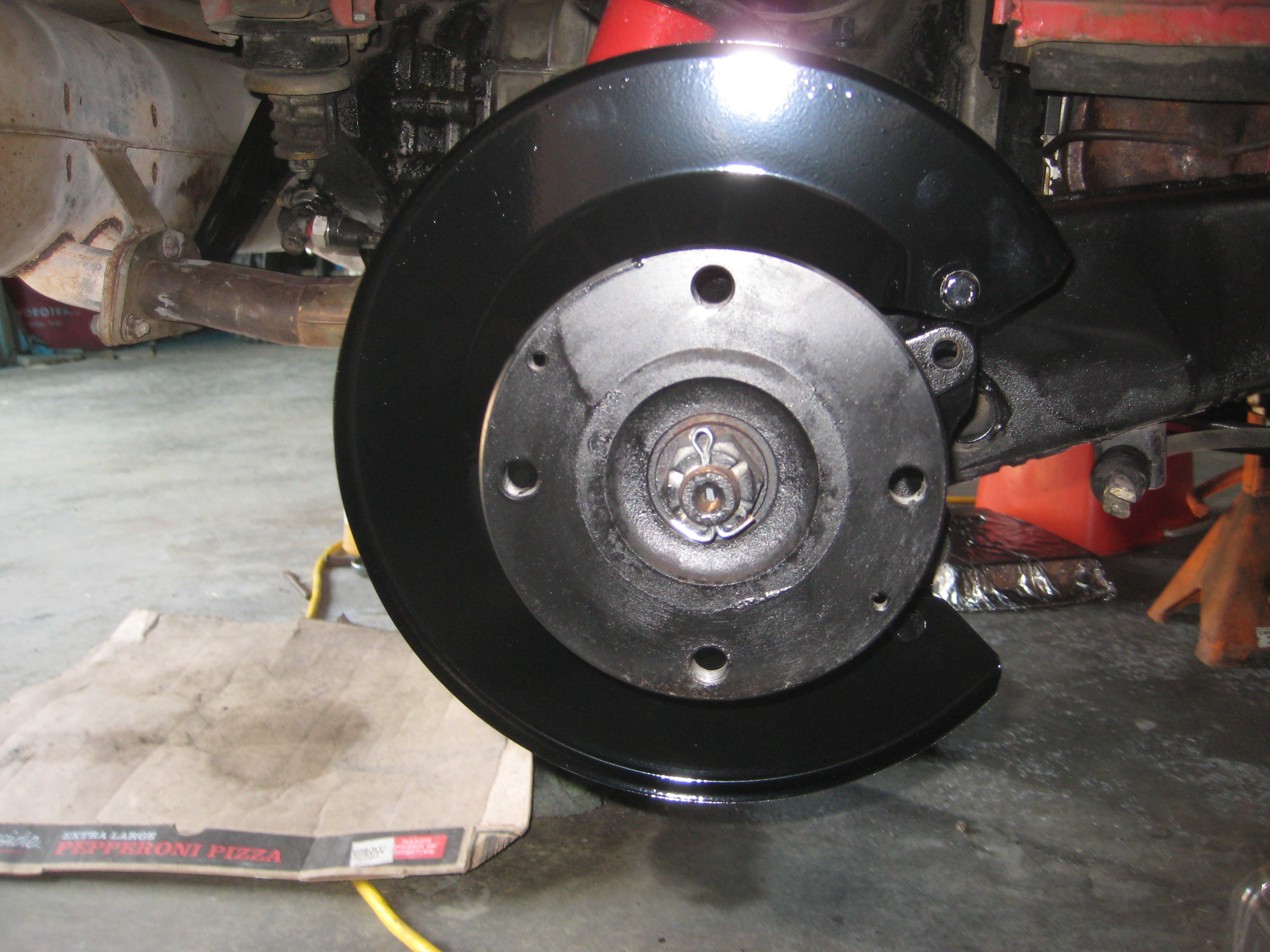

The disc guards were powdercoated mirror black.
Click to view attachment I even powdercoated the mounting bolts and washers, as they were getting pretty oxidized.

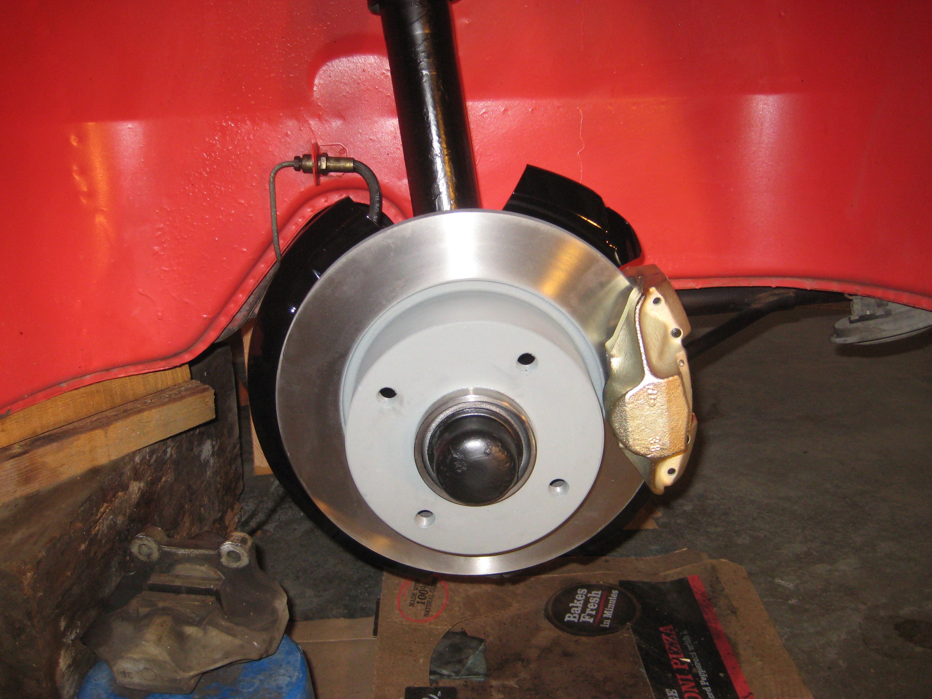

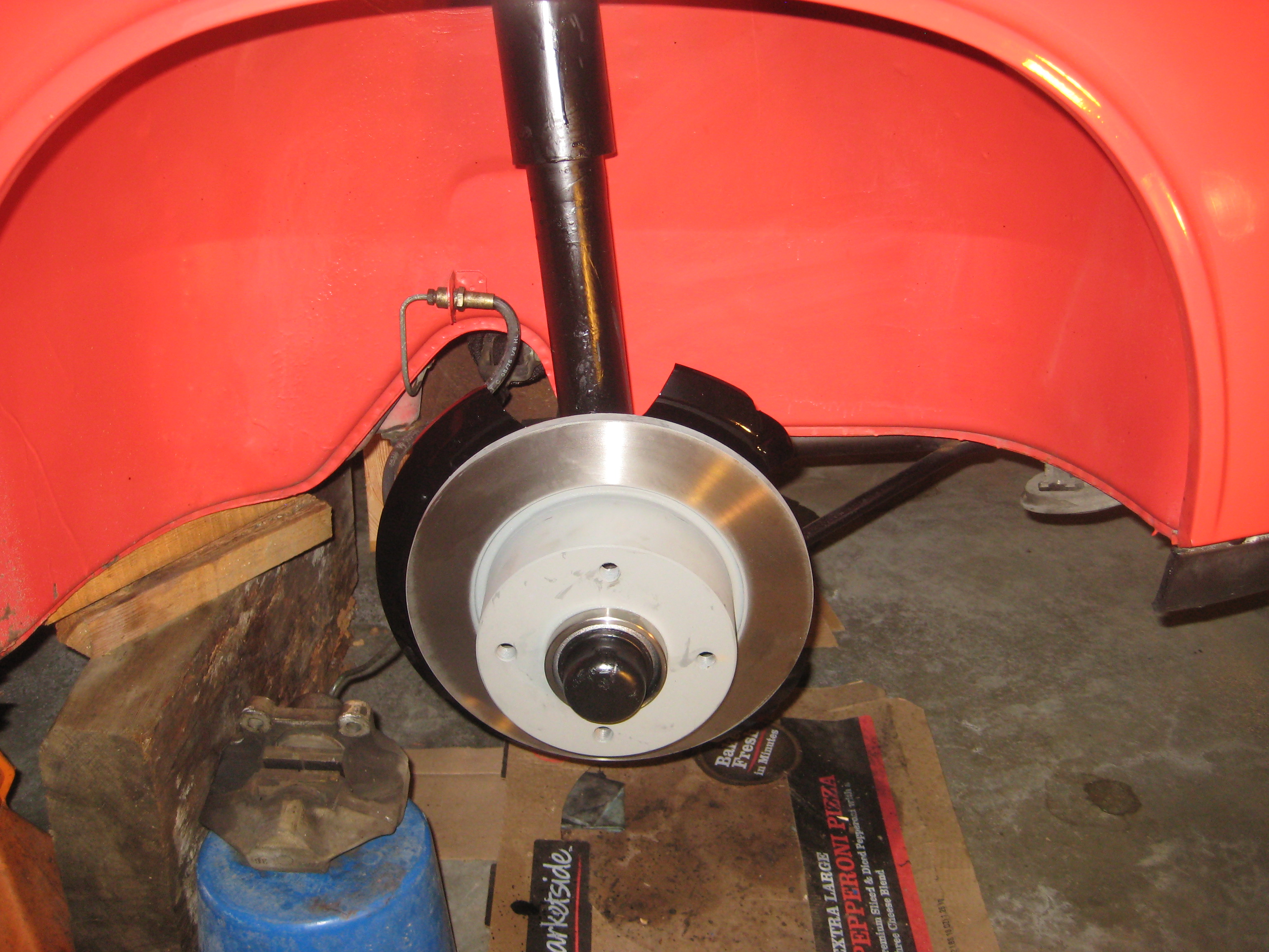

The same steps were used for the front of the car.
Before
Click to view attachment After

Today I heated the front rotors up to about 300 degrees and had the front wheel bearing races in the freezer overnight. I found two sockets that were just under the OD of the races, and once the rotors were heated up I dropped the bearing races in and tapped them down and seated them. The heating of the rotors and freezing of the races will gain you several thousandths of clearance when installing them. I also measured with my vernier to ensure the races were seated and matched the rotors I removed.
After packing the bearings with wheel bearing grease and installing the inner seal, the rotors were installed. The locking nut was adjusted to have zero clearance, but the rotor spun easily. I had some difficulty putting the bearing cap back on. I looked around and found a piece of pipe that fit the outer flange on the cap, and was able to pound it on. Here is a picture of how it turned out.
Click to view attachment Here it is with the new re-manufactured caliper from PMB:
Click to view attachment You can see the original caliper to the bottom left. Once the new hard line and rubber line are installed this corner will be ready for a bleed job and ready for another 40 years of cruising!
