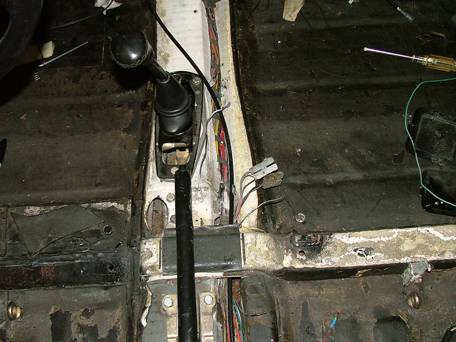

It is my understanding that from '73 up the vehicles had the wiring harness for the center console regardless of whether the console was installed or not. There was connector just forward of the shifter in the main loom that runs in the center tunnel. It not only provided for the wires from the sender, but power to the gauge lighting and grounds. I this picture shows the connector but it is behind the shifter? The wiring for the PO removed console in my car did not come from here but came from elsewhere.

Lucky9146   It is my understanding that from '73 up the ve...   Aug 22 2015, 10:07 AM
tp_reading   It is my understanding that from '73 up the v...   Aug 22 2015, 01:36 PM
Lucky9146   [quote name='Lucky9146' post='2227015' date='Aug ...   Aug 22 2015, 09:14 PM
tp_reading   [quote name='Lucky9146' post='2227015' date='Aug...   Aug 23 2015, 07:23 AM
mepstein   99% sure those connectors plug into a seperate (sm...   Aug 22 2015, 10:38 AM
SLITS   You found the center console connectors. Sent a P...   Aug 23 2015, 07:18 AM
