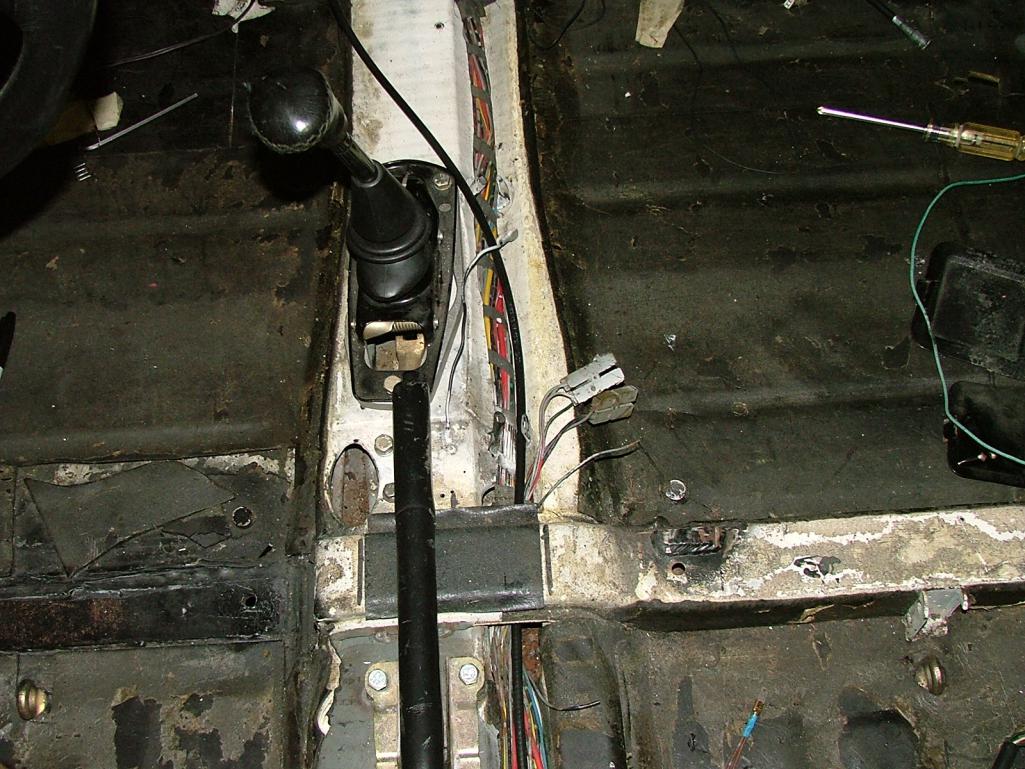

It is my understanding that from '73 up the vehicles had the wiring harness for the center console regardless of whether the console was installed or not. There was connector just forward of the shifter in the main loom that runs in the center tunnel. It not only provided for the wires from the sender, but power to the gauge lighting and grounds. I this picture shows the connector but it is behind the shifter? The wiring for the PO removed console in my car did not come from here but came from elsewhere.

QUOTE(Lucky9146 @ Aug 22 2015, 05:07 PM) *
Hi, interested to see from this pic that you have a parking brake lever situated centrally. I have 930 discs on the back, and hence no parking brake. Any info on your set up would be much appreciated.

QUOTE(tp_reading @ Aug 22 2015, 12:36 PM) *
Cheers,
Tony
Tony,
Good eye! Afraid its a good news bads news scenario. I picked up on this car where someone else left off and that PO= Previous Owner installed the console e-brake. I love the idea btw. It has yet to be hooked up and he had custom cables made to boot. He later found a post of a much nicer setup that someone else had done using standard cables that when he saw it he liked it better and wished he had done it, but he felt pretty comitted with welded in nuts and all already. And so I went looking and found the link for you of the better set up. Hope this helps! Let me know if link does not work and I will try again. I can show more pictures if you like of mine but it is not yet proven. So if I had it to do from scratch I would probaby go with the better set up.
http://www.914world.com/bbs2/index.php?sho...6791&st=380
Take care
Update I can't get the link to work sorry but the guy who posted it was Jeff Hail search him out and the post was Feb 2011

mepstein   99% sure those connectors plug into a seperate (sm...   Aug 22 2015, 10:38 AM
SLITS   You found the center console connectors. Sent a P...   Aug 23 2015, 07:18 AM
