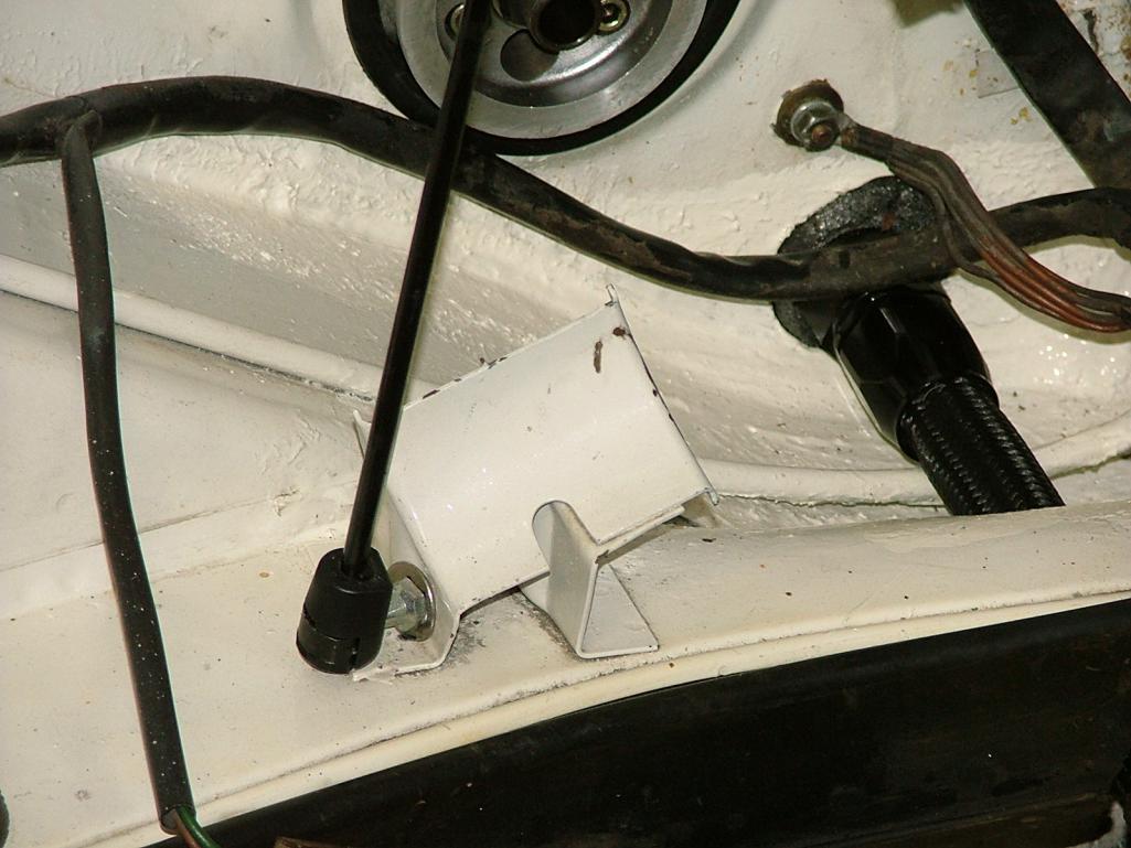

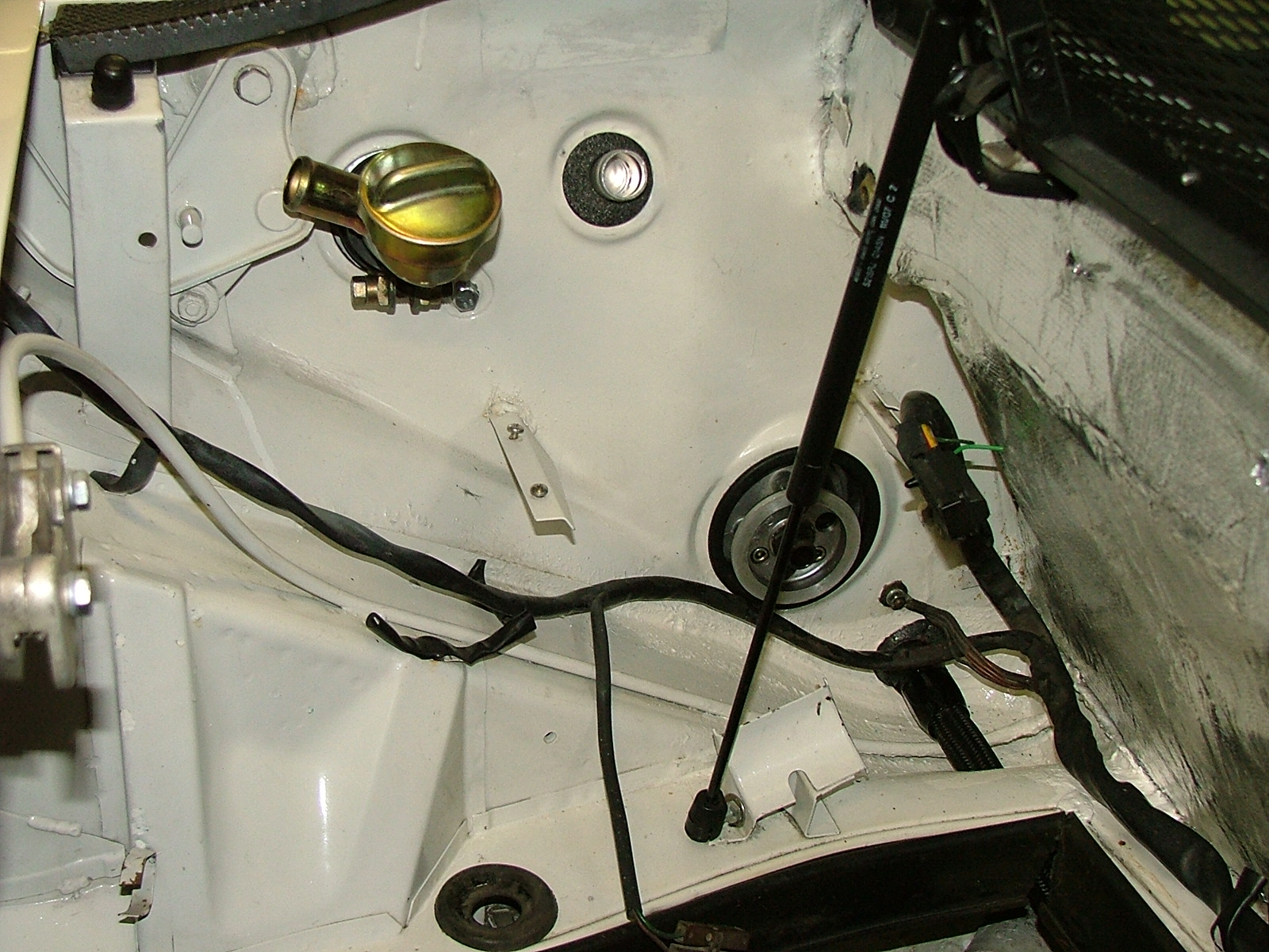

Anybody with a 74 take a look at my newly installed oil tank area. What a pain but the tank is in. A lot of "trial fits" but done. There is a strut on my car for the engine lid but it looks like the strut mount/ bracket is suppose to do a lot more by the looks of it. I don't know. Anyway the upper most corner of the bracket is in the way of installing the oil filter. The strut itself will clear it is just the upper corner of the bracket is in the way. Did you have to cut or modify this mount/ bracket thing to get the oil filter to fit?

Lucky9146   Anybody with a 74 take a look at my newly installe...   Aug 24 2015, 01:19 PM
rhodyguy   Pm sent.   Aug 24 2015, 01:21 PM
Lucky9146   So learn as you go. Seems the lower bracket for m...   Aug 24 2015, 02:10 PM
OllieG   I wasn't sure what that bracket on mine was fo...   Aug 28 2015, 03:10 AM
