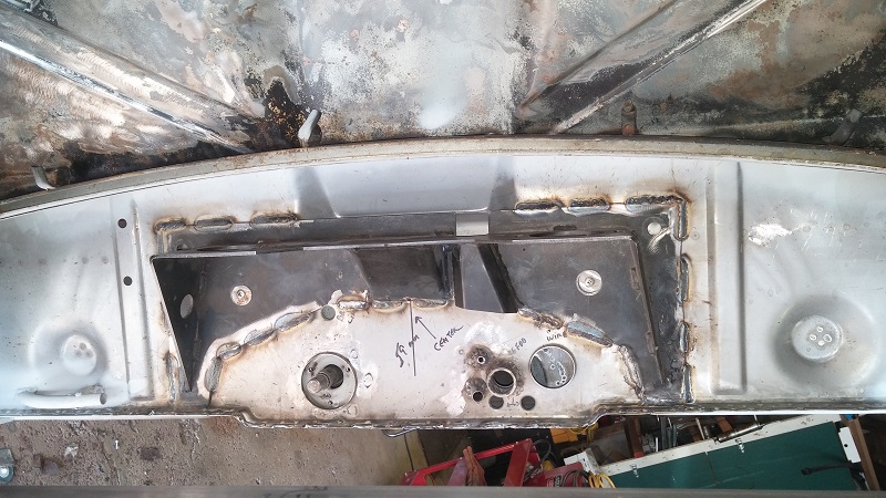

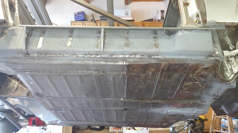

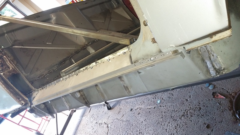

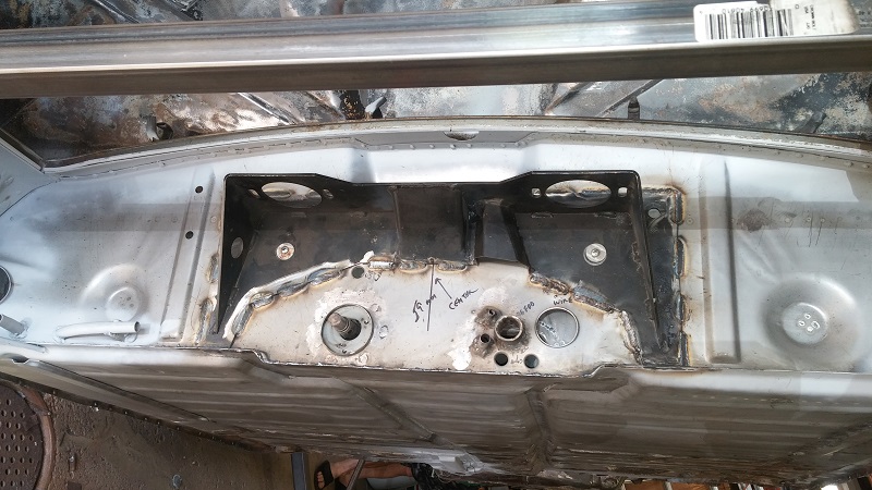

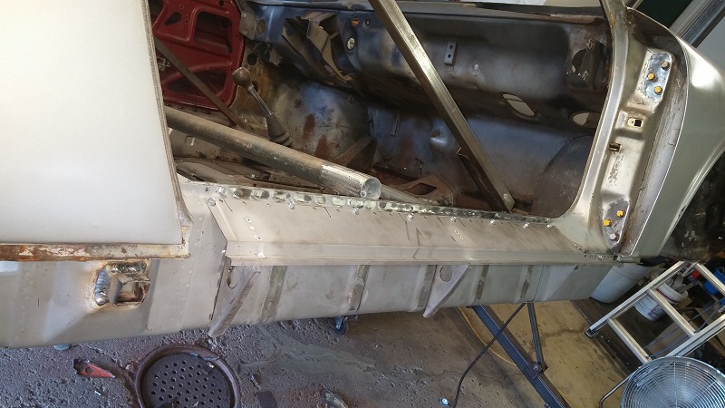

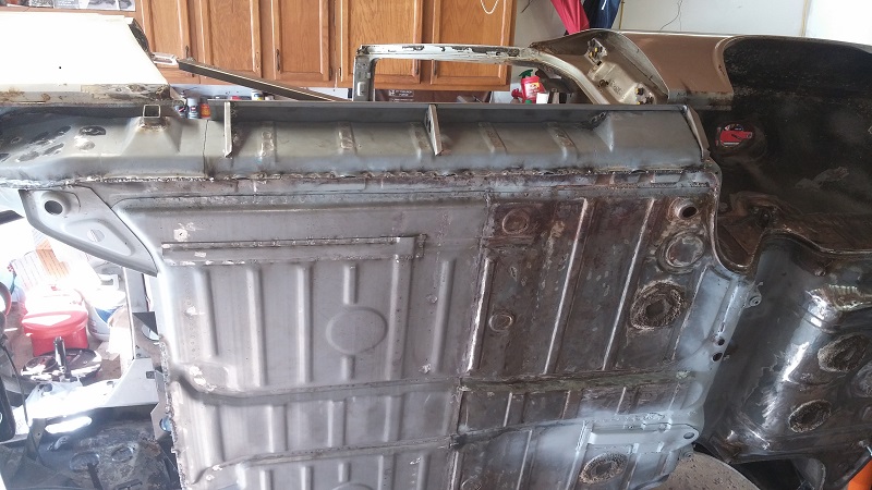

The case and a few other parts came back from the machine shop at end of last week. I'm waiting on two vendors to send me the rest of my parts order so in the mean time we knocked out some more chassis work. We got the RJ engine mount, right frame stiffener, and sill welded in.
