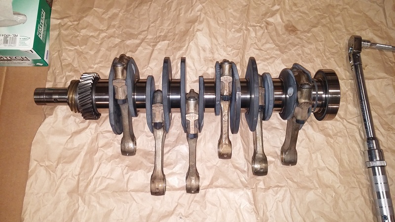

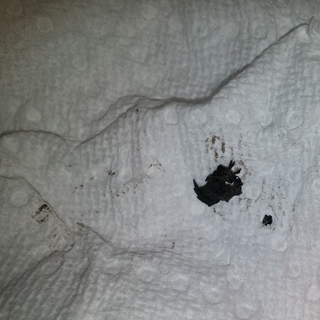

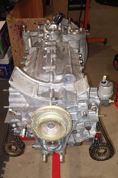

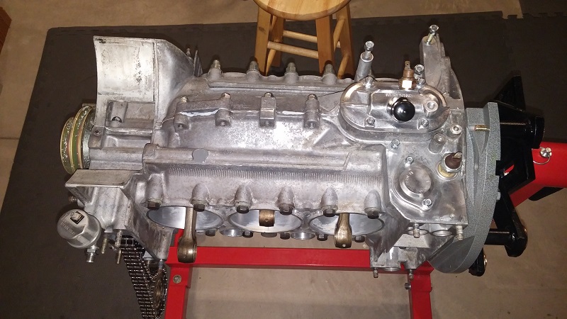

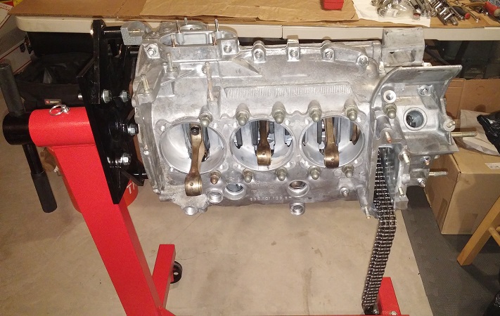

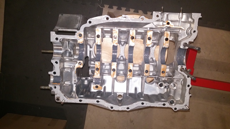

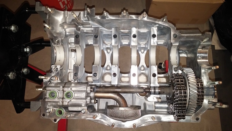

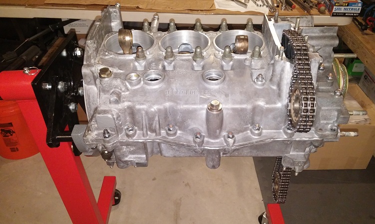

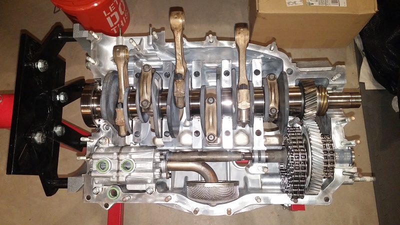

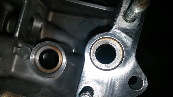

It's too darn hot 90+ in the garage to do any welding so more engine work was done.
I got the case all cleaned up and JB weld applied to the areas that needed it. I had the machine shop clean the case and it came out looking pretty good. I still gave it a once over before the assembly started. I'm glad that I did as I found a large piece of aluminum stuck in one of the oil pump feed holes. It was stuck in there pretty good but it finally came out. It goes to show to always inspect and clean even after it was done by someone else. Then I got the rods mounted to the crank, oil pump/shaft installed into the case. Time to seal it up.
