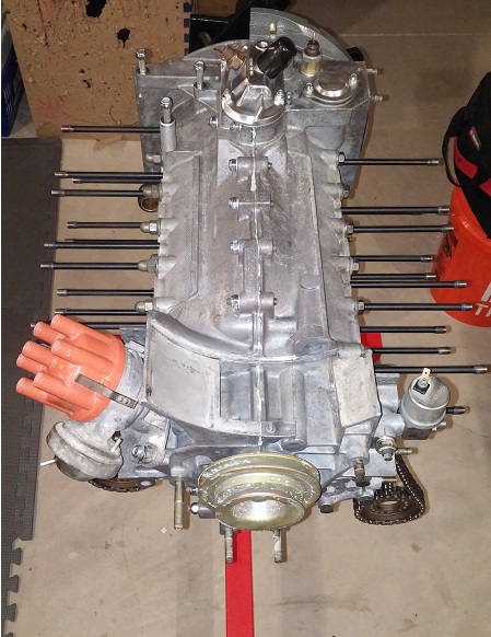

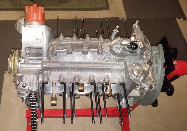

I got the head studs installed and set to 135 mm . They are all steel studs with some type of coating on them. Temporarily dropped the dizzy in as well.
This engine is getting some JE pistons with some reconditioned Nikasil cylinders.
(IMG:style_emoticons/default/beer3.gif)
