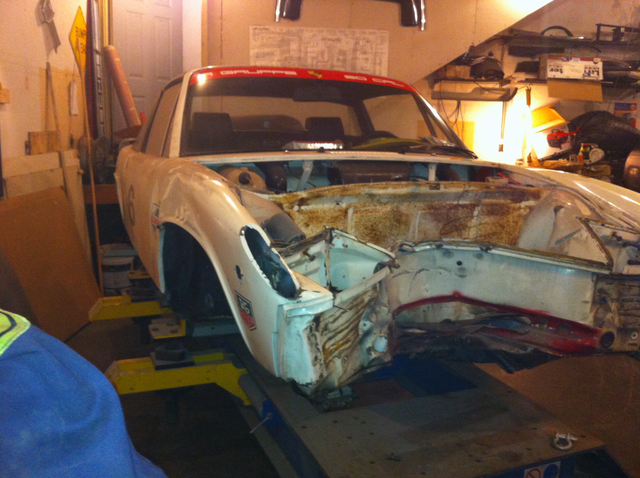

Time for an update. I really shouldn't have spent the time out in the garage this weekend but I did. I'll pay for it tomorrow at work. (IMG:style_emoticons/default/dry.gif) But hey I couldn't stand to see the six sit there idle another month.
I pulled out the tower, hooked it up to the Celette and did the rough in pulled. Some know I have a little experience with this. I owned a collision/resto shop for 18 years. I had a 4000 sf shop with a 1300 sf computerized office, 6 full time employees and all the drama that goes with it.
For those that are interested in the approach to proper collision repair on a unitized car I'll give you a little taste of the process and the how and how not to proceed.
First you need to picture a car built like a wire framework. Push on one corner and the wire frame moved is several different directions throughout the structure. Now image the wire frame is bent like the photos I will post. The object is to use the damaged structure, specially the parts you know you will not re-use to move the wire frame back into position.
Imagine you just say, heck, I'm not using the front handle I'm just going to cut it off. Proceed that way and you will trap damage back into the wire frame with no way to pull it evenly and move all the members back into position. When you go to re-assemble you will have issues with door fit, top fit and chassis balance, braking predictability and cornering. It is also possible the chassis will end up with kinked or pre-damaged members that will make it unsafe.
So, here's the plan. Do the rough-in pulls. This does not require fixtures those will come later. My goal is to relieve the stress introduced into the unit-body,(drag all the wires effected back in place) start to reshape both right and left inner wheelhouses. and prepare the car for the removal of the parts I will not need when I get the fixtures from Celette and start rebuilding the chassis.
Here's where I started.

rick 918-S   The car is set up on the Celette. There is a set o...   Sep 13 2015, 09:53 PM

rick 918-S   So here is where I'm at today. The rough-in is...   Sep 13 2015, 09:59 PM
bandjoey   Wow. The initial pull is impressive. Good work...   Sep 13 2015, 10:22 PM
